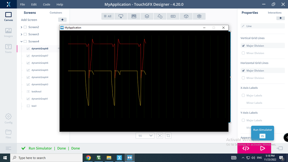

my graph configuration
0693W00000WJL6VQAX.pngThis is the problem my data is not correct in yellow graph in difference with red one!
Hi NSabo,
can you please create a NEW Question? Then others can answer accordingly to your request.
If you post in my thread, I get notifications and emails related to my question, which actually have nothing to do with my original question. Thank you.
