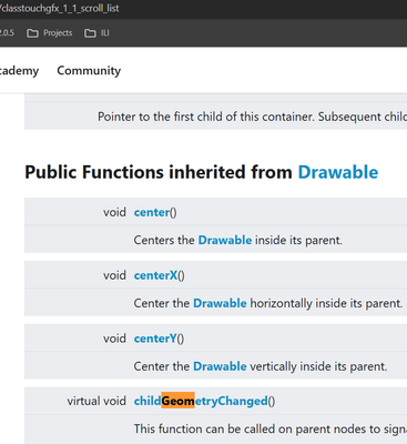

The scrollList inherit from drawable which have the method childGeometryChanged :
Setting the drag speed to 0 indeed prevent any movement, that could be a workaround for you. :)
Have you tried to call childGeometryChanged() though?

I've called
mySelectorScroll.childGeometryChanged();
mySelectorScroll.allowVerticalDrag(false);
but the issue persisted
Can you try to put the childGeometryUpdate after the allowVerticalDrag?
