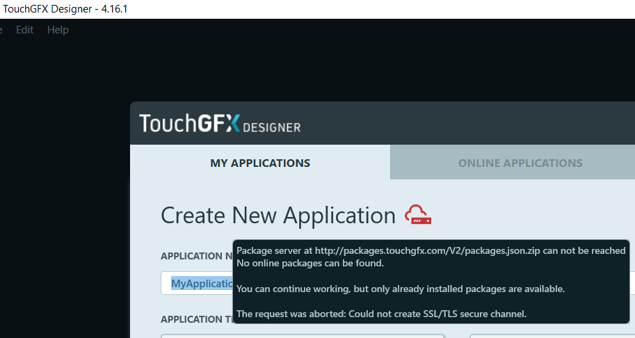

MMaun.1
Unfortunately this problem has been persisted now for 6 months. I have tried to install 18.1 and then 16.1 but with no luck. I do not have existing installation since I have changed my computer several times. I know some IT departments are slow but 6 months....
Below I have screen shot from TGFX 16.1, which tells that I have no access to packages.json.zip on packages.touchgfx.com site. Which is correct since either ping nor traceroute could not find the site. So the problem is not the operating system or its version but the server. There is no longer any site called touchgfx.com. Its forwarding to st.com site.
This situation is sad because the program itself is excellent in its field.

The server was down yesterday. Another post on the forum was put to warn people. It should now be back to normal.
/Romain
What OS are you using ? Yesterday the server was down as well but it should now be back to normal.
Would moving to the latest versions of TouchGFX be an option for you ? If I recall correctly there was an issue with this version concerning proxy logins. I cannot remember if it impacted 4.16.1 or 4.17 though.
This post unfortunately also mixes different issues. Could you be more specific on your issue exactly ? How long have you been trying, on what versions, did you try opening microsoft edge before opeing touchgfx to make sure it has access to internet, etc... Could you share your log file as well ? You can find it under %appdata%/Roaming/TouchGFX-4.16.1
/Romain
Could you ask your students who could not connect to the server to first open a browser like Microsoft edge to be sure TouchGFX Designer has access to the server ? If it still does not work could they share their logfiles found under %appdata%/Roaming/TouchGFX-4.17.0.
Would moving to the latest version be an option ? TouchGFX 4.17.0 faced an issue where people could not enter their proxy login, which is not a necessary step for everyone but i would not be surprised if computers in a schrool would ask for it (but then it should impact all pcs not just a few)
/Romain
I've just noticed that this forum page connects with TLS 1.2. I do not see why the demos served to TouchGFX Designer need to connect with TLS 1.3. It seems absurd to enforce such a strict standard for demos and not for the rest of their web services.
