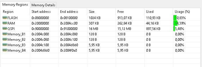

ok, I cannot boot from QSPI but can I move part of the my program in QSPI to save flash space like I do for the images ?
‎2022-01-28 9:52 AM
Yes, the design supports execute-in-place
‎2022-01-28 11:29 AM
Could you show me a sample ?

‎2022-01-31 12:07 AM
I see that using this modification the function go in QSPI and the flash used is reduced.
Is this correct ?
static void Page1(void);
// void Page1(void);
main()
Page1();
static void __attribute__((section(".textqspi"), noinline)) Page1(void)
//void Page1()
In any case I see that it possible pass in the QSPI only some user parts of code because other parts like the graphic lib must run in flash.
