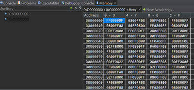

For reference, TouchGFX Designer version 4.25.0, CubeIDE version 1.18.1, and CubeMX version 6.14.0 are currently in use. The attached photo is a screenshot of the memory view taken during debugging. It appears that the values are not being read correctly.
I set the start address to 0xD0000000 using SDRAM bank 2. Is this correct?

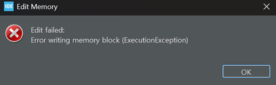

Oh, and I tried to modify the value in the memory view, but an error occurred as shown in the attached photo.
Hello @newbiee ,
Have you been able to isolate the memory usage to check that it works?
Have you tried a project that doesn't use external memory?
Are you trying to use TouchGFX yet or are you just trying to control the screen and get it solid red?

Write test code independently of TouchGFX
Test the SDRAM, perhaps make a "MEMTEST" type application walking patterns in the memory to prove it all works, retains, and is addressable.
Test the LTDC on internal memory, I think it just loops in a circular fashion, so you should be able to test with a smaller frame buffer, and solid colour patterns. FLASH might also be a viable source, you've got 2MB of that, it'll give you a colourful hash/tartan type pattern, but will be non-white if the timing is reasonably solid.
