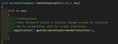

Hello, it is possible to call a function to change screens in a "stm32h5xx_it.c" file?
The goal here is redirect user to a different screen globally, with no need to do this in every screen individually. This function is called in "EXTI15_IRQHandler(void)" in the same file, which is a hardware button of mine.

Hello @matheuschiarelli ,
If you want to change screen in code, you need to generate the functions for it.
If you create 2 screens and you add an interaction to switch from screen1 to screen2, TouchGFX Generator will generate the function for that in the screen1 cpp base file:
Then, you can call that function yourself.
But you need to know which screen you are in right now to be able to call the correct function with something like:
application().gotoScreen2ScreenNoTransition();
Regards,
Gaetan Godart

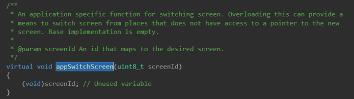

Hi @matheuschiarelli
there is
application().appSwitchScreen ( screenId );
in \touchgfx\framework\include\touchgfx\Application.hpp
This approach assumes that GoToYourScreen () is/are already present.

Okay, i'm doing this at the moment. I was hoping to find a solution where i can call change screen functions outside touchgfx files, but if this isn't possible i will follow that way!

You can ask to change screen in whatever other file, just follow TDK's guideline.
You could change a variable when you want to change screen and read that variable in HandleTickFunction of the model.ccp file or you could use the RTOS (if you use one) semaphores/queue to call the function to change the screen.
