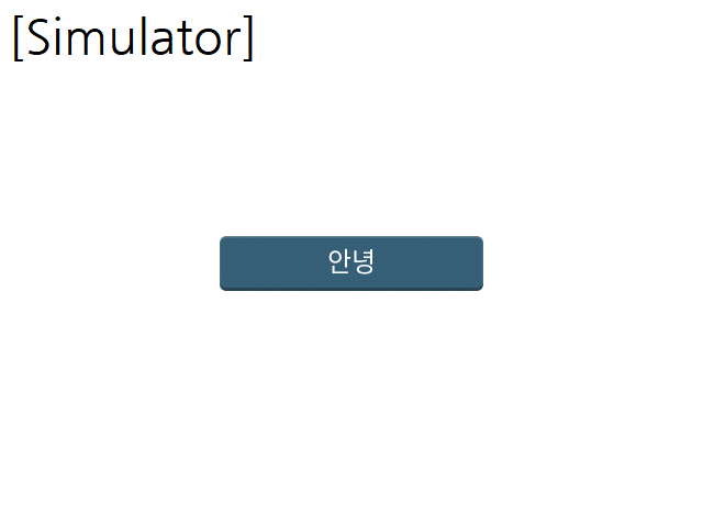

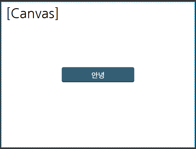

Hi, I am a Korean developer.
So, I use Korean to mark the text.
But there's a little problem.
First, after organize the UI on the canvas,
When I run the simulation, the position of the Korean characters(Text Area) does not exactly match the position I set, or the font looks a little different.
Even if I use other Korean fonts, this phenomenon occurs.
How can I solve this problem?

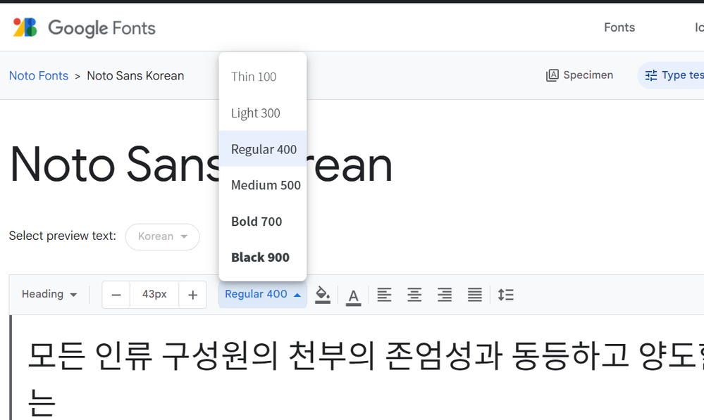

- Used Fonts: Noto Sans KR

As a workaround I can suggest you to use the setBaseline() function to make sure the position of your text is exactly where you want. Concerning the font look, I have no idea, it looks like it the same font but a different style:
You can try another style and select the one you prefer for your text on simulator and not on the canvas. But I agree it's not optimal to have something on the canvas which is not the same as when you run on simulator.

Here are two screens for comparison from my app:
Canvas:
Simulation:
Also, in GFX:Tetxts it is possible to use languages/glyphs which are not available in "Src\assets\fonts\" because they are fetched by GFX from Windows OS. And only when simulation runs those previously recognised glyphs are replaced by 'fallback characters' - because missing in "Src\assets\fonts\".
