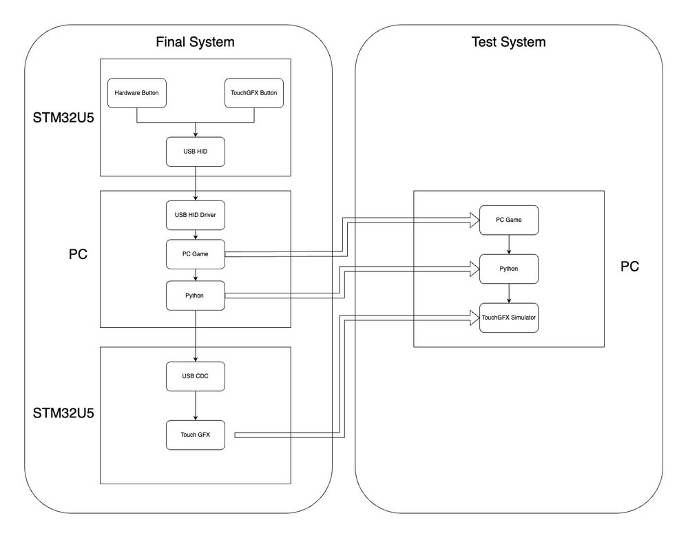

Apologies, I did not convoy my system very well so I have made a digram.EliteHID_Digram.jpg
Python is a place holder in the final system for now until I figure out how to do it nicely, but I will use python in the test system.  So if I understand correctly I can just treat the simulator as a C++ program and work with it similar to how I would usually modify files as if it were running on an MCU? How does that work with FreeRTOS? If I add a new file that will act as the link between the simulator and python do I need to put it into a FreeRTOS thread? My experience with C and C++ is limited to Embedded systems unfortunately.

Hello @WrenchInTheWorks ,
No problem!
In the final system, why do you want to run the game on a PC? Since an STM32 is basically a mini PC (MCU), you could run the controls, game and display on a single chip if the game is simple enough.
The simulator is an executable file. But every TouchGFX project have a different simulator file because the simulator just ask the computer to render that specific TouchGFX application and to display it on a SDL window.
Yes, you can add files as you want so you can make your custom code that run your game, renders the image, etc.
But then you have to fill the TouchGFX framebuffer with the data and just use the simulator to display the framebuffer in an SDL window because again, TouchGFX is used to add elements and render them in an efficient manner optimized for embedded use and store the image in a framebuffer, displaying the framebuffer is then up to the user.
But then you miss the point of TouchGFX, you are not using TouchGFX then, at this point just read the SDL documentation and display a few pixels on a widow, it is not that hard.
If you use the simulator, it is the computer that run the program, so the computer already have it's own resource management system. You don't even need FreeRTOS to run TouchGFX on a mcu actually.
You can also fetch the keyboard input in TouchGFX (it is very easy when running the simulator).

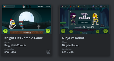

For the test system, I think that either you design your game with the TouchGFX framework (which is not designed for that but it is possible) like we did for the knight vs zombie and ninja vs robot games (we also made a 2048 game and others) :
or just don't use TouchGFX.
instead, design your game how you want and just render a window on your computer screen by an actually adapted way.
Then, for the final system, you can use TouchGFX for the lower STM32U5 that (I assume) has to show the game on a screen. To do that, you have to send the image X times every second to the STM32U5 and then show it on the display you choose.

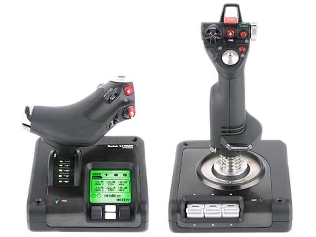

Thank you for checking in! Still not quite on the same page about the project, but that's ok, I'm building a control device similar to the bellow image with the screen running touchGFX, it is a fully fledged PC game that my device will interface too and display info from using a limited game api.

Based on the image, it looks like you only need one MCU, it will get the button click as interrupts and it will also control the screen. Regarding the API, I am not sure if you can do that through the MCU or if you have to do it through the computer.
For the test system on simulator, you can add interactions of "key pressed" for each of the physical buttons you want to have latter on. So basically mapping in your head : "the side button of the joystick is the key 'L' on the keyboard", "the 3 bottom buttons of the joystick are G, H and J".
