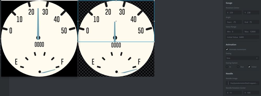

I'm using TouchGFX 4.19.1. My speedometer gauge worked fine originally, for a 390x390 display. I need it to work on a 480x480 display so scaled up the background image and needle image and resized the gauge widget. Now I struggle to centre the needle, and the actual image (in simulator and on target) differs from what TouchGFX displays. Changes to the needle rotation centre are not reflected in the simulator/target. This must be related to the relationship between image and widget sizes. Attached is a snip of the simulator (LHS) versus the TouchGFX image (RHS). Has anyone else experienced this?
0693W00000NqsuJQAR.jpgGauge widget size is 480 x 260. Needle and background images supplied.

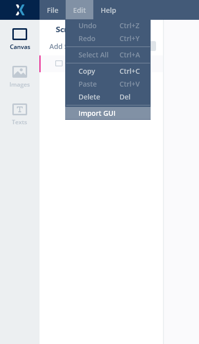

Could you please share your whole project or at least the UI ?
To do that, you can create a new TouchGFX project, and then click on Edit > Import GUI.
That could be very helpful to try to reproduce the issue.

Your issue come from these functions, located in RunningScreenView.cpp :
0693W00000Nqvl0QAB.pngI don't know what you are trying to do with that, but it apparently shifts your gauge background and needle, and then those widgets look misplaced on the display. After commenting these lines, both the needle and the gauge were displayed on simulator exactly like in the TouchGFXDesigner Canvas menu.
I also added a new screen to the project to check if everything worked fine if you add a default gauge to your project, which is the case, and I corrected the positioning of the needles in the Running Screen.
I will share the updated project back.
Let me know if that solved your issue,
/Yoann
