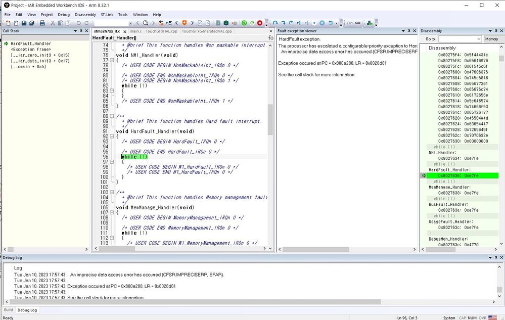

I want to use the touchgfx video widget for my STM32H743II custom board.
LSoo.2
The custom board has completed image upload verification with Touchgfx.
I set it according to the Touchgfx video decoding.
I tried to execute it, but an error occurs.
A hard fault error occurs before entering the main loop.
0693W00000Y7p6eQAB.jpgI use the version below.
IAR 8.32.1
Touchgfx 4.20.0
CubeMx 6.6.0
Is the video widget function available on touchgfx with STM32H743II MCU?

Hello LSoo.2,
Could be multiple reasons for that. You can use STM32F769-Disco, STM32H750B-Disco and
STM32F746-Disco TBSs available on TouchGFX Designer as reference and try to compare your project with these ones.
My advice : I would start looking on the linker script :)
/Osman
