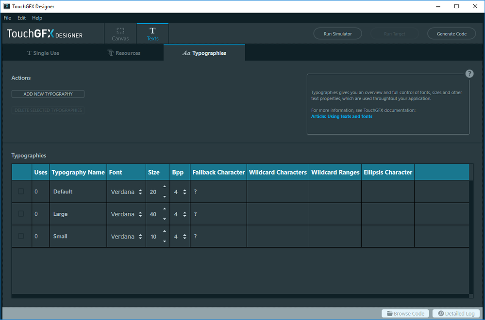

I'm seeing a ? instead of W in both simulator and target.
Is this a bug?
- Labels:
TouchGFX
‎2019-07-12 4:16 AM
Hi Antoine,
I seems that you have pasted the same code snippet twice.
When TouchGFX displays a "?" instead of the desired character it is usually because the glyph for that unicode is not within the wildcard characters/ranges.
You can add these characters in the Designer under Texts -> Topographies
Regards

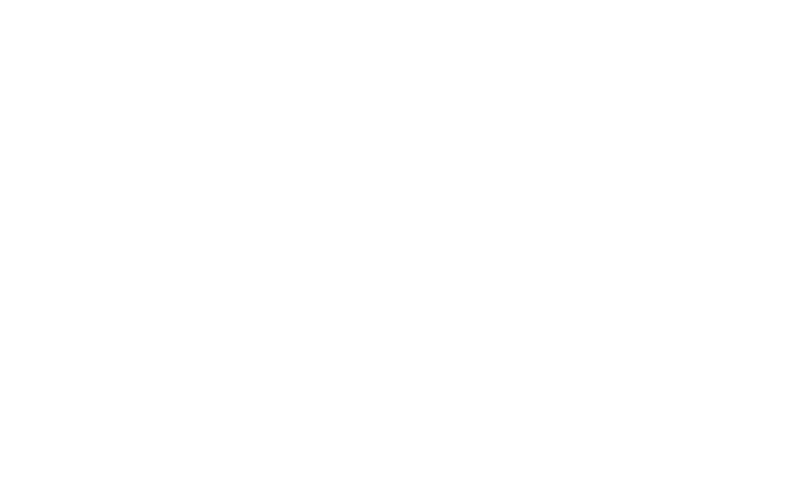

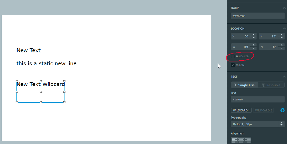

The text area where you have a wildcard which contains newlines, you need to remove the check "Auto-size" in the Designer and then expand the size of the text area.
Adding new lines are done as usual with \n
Unicode::fromUTF8((const uint8_t*) "Hello World!!\nNew line", textArea2Buffer, TEXTAREA2_SIZE);
textArea2.invalidate();
Running the application will yields "New line" written on a new line for a wildcard text (BTW, pressing F3 creates a screenshot of the simulator)

Removing Auto-size seemed a bit counter intuitive, but yes, that worked. Thanks!
‎2019-07-18 11:38 PM
That's because the "auto-size" calculation is done before the code is generated -> The Designer calculates the size of the text input and then sets up the high and width of the text widget.
The wildcard rendering is done at run time, and thus the needed size of the text widget is unknown.
/Anders
‎2019-08-05 5:43 AM
Yeah, it's a bit counter intuitive because for wildcards the width will be 0 if there's no initial value in the buffer and you have to resize it manually after manually updating the buffer.
