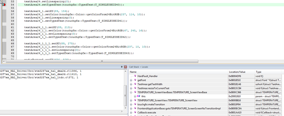

System halts on function getFont
EEuge
Senior
Look at breakpoint - this function halts (program go to HardFault)
You can see callstack.
How to find course of problem?

Hello, is the stack size proper for the application? (check and Static Call Graph)
EEuge
Senior
Stack 0x2000 HEAP 0x4000
"(check and Static Call Graph)" - I can't understand this, explain please.
MM..1
Chief III
Check your definition line for gui task, here need be when you use defaulot task
osThreadDef(defaultTask, StartDefaultTask, osPriorityNormal, 0, 4096);
