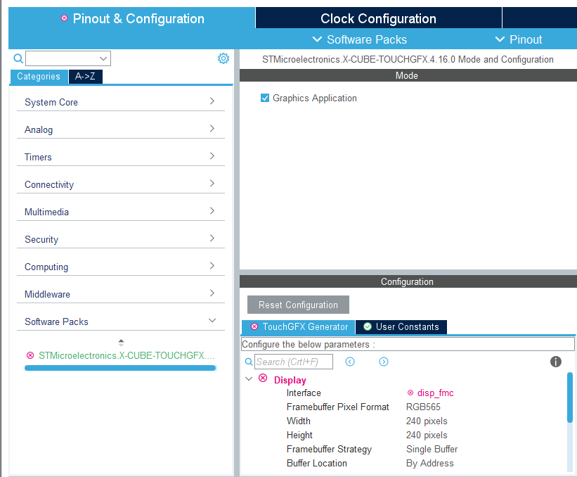

However i want to open and edit the Project and write Code and Logic for the GUI with an IDE (STM Cube IDE in my Case). So after i Generate Code from the Touch GFX Designer i open the Project with STM CubeMX to generate a project with STM Cube IDE as target IDE and check the box with 'Generate Under Root'.
The first problem here is that CubeMX is showing me an Error in the Pinout & Configurations tab under Software Packs -> STM X-Cube TouchGFX (i'm using version 4.16.0, since 4.16.1 doesn't seem to be supported by TouchGFX Designer) -> TouchGFX Generator -> Display -> Interface is set to disp_fmc and marked with a pink 'X' (see image below) the only other Option i can choose for this is Custom, which will lead to the same compiling errors in CubeIDE.

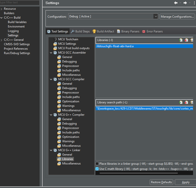

C:/ST/STM32CubeIDE_1.13.2/STM32CubeIDE/plugins/com.st.stm32cube.ide.mcu.externaltools.gnu-tools-for-stm32.11.3.rel1.win32_1.1.1.202309131626/tools/bin/../lib/gcc/arm-none-eabi/11.3.1/../../../../arm-none-eabi/bin/ld.exe: cannot find -l:libtouchgfx-float-abi-hard.a: No such file or directory
collect2.exe: error: ld returned 1 exit status
"make -j8 all" terminated with exit code 2. Build might be incomplete.
I also check the setting patch but I don't know what I have to do there
