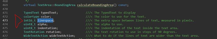

i would need information about setLineSpacing (int16 space) method in textarea widget.
Documentation says that it's used for increasing space between lines, but the parameter "space" defines the space in pixel or other unit measurement ?
Thanks a lot anyone can help me

Hi @bobbi5
"the parameter "space" defines the space in pixel"
Seems so, yes
\include\touchgfx\widgets\TextArea.hpp

ferro
Lead
Hi @bobbi5
Seems so, yes
bobbi5
Hi @ferro , thank you so much
