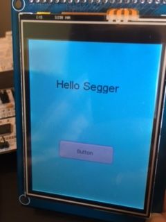

‎2017-05-09 5:56 PM
Hi
I have the basic GUI screen integrated into the project and looks good:) I have attached the pic with this.
The screens load like a flash! And this is running @24Mhz clock! And the current at that clock speed is 7mA !!!! And this is STM32F4 - this can still be better if I shut-down the peripharals that are not in use.
Further, I plan to use STM32L4 for which I expect the current to be even lower to about 4mA !!
