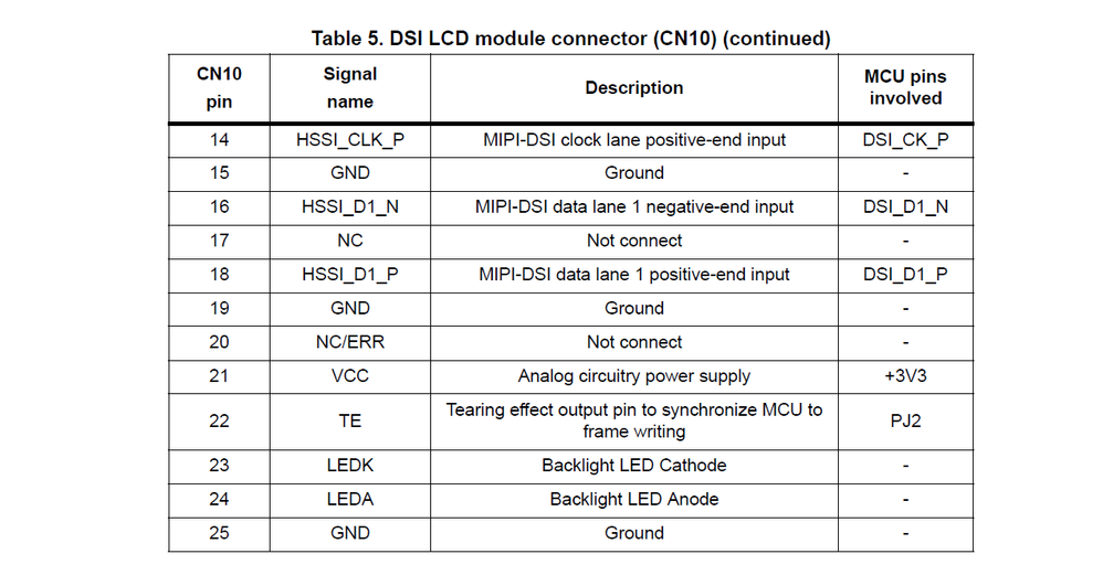

Hello everyone,
I am using the STM32F469i-disco for my touch screen project and I was able to modify the sample example in the STM32Cube_FW_F4_V1 to satisfy my project. ( ..\STM32Cube_FW_F4_V1\Projects\STM32469I-Discovery\Examples\BSP) Now I am trying to use the STM32F469BIT6 (TQFP176 ) instead of the BGA one used in the Discovery board.
My problem is I do not find a way to change the DSI_TE pin in the Library from PJ2. I looked everywhere in the code but I do not find it.
Thank you for your help

Posted on July 23, 2017 at 10:17
The tearing effect is an effect similar to judder.
It is the pin 22 of the LCD module connector CN10 (TE), since the
STM32F469BIT6 (TQFP176 ) does not have PJ2, I need to move it to another port and I need to change the pin in the software!
