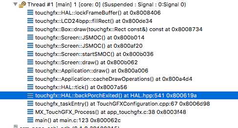

I try to connect LCD by SPI to Nucleo-767 and TouchGFX.
LCD screen work perfect and I could draw on it without a problem, but I stuck with TouchGFX.
I found that void TouchGFXHAL::flushFrameBuffer never call.
Check this video - https://youtu.be/1UhEx7E_dH0
What I did:
  1. New project for my board
  2. Make timer for VSync each 15ms
  3. Add TouchGFX Generator package
  4. Add CRC
  5. In TouchGFX settings set size 320x240 and RGB888.
  6. Open TouchGFX Designer, add button, and generate code.
  7. In code add start & callback for timer and call function for generate tick
  8. add switch on led on board.
LED doesn't light.
Of course, I checked that timer callback works, led works.
In debug mode I found that app stuck in lockFrameBuffer function.
What I did wrong?

Try show your code here for example

 Stacktrace on pause
Place breakpoint in
void HAL_TIM_PeriodElapsedCallback(TIM_HandleTypeDef *htim)
    if (htim->Instance == TIM13) {
        touchgfx_signalVSyncTimer();
check period of call and start with longer periods. You need time to render full one frame.
