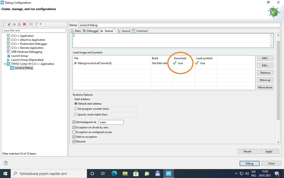

Hi all,
I'm building a custom board with touchgfx and QSPI resources.
Everything work well!
I would like to know how is possible to remove loader to fast the debugger session: the external resource need more than 4Mbytes and loader everytime I start a debug session update the external memory. This process take about 1 and half minute.
the problem is that I don't updating nothing on graphic design, but I'm adding only code to my project: everytime I program the uC everything is erased and reprogrammed.
So I would like to have the possibility to run the project, loading the external QSPI resources needed by graphic stack and correct as fast as possible my code. Is it possible?
( I'm know where remove the loader (on debug settings) and I know how to edit the linker to add/remove external reosurces: but if I edit the linker, Touchgfx don't know where load the picutres and fonts from) . how can I solve it?

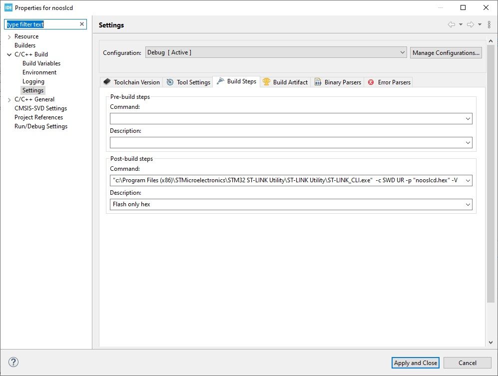

You dont write how IDE used , but simply you need only skip flash external section ,,,

Here in CubeIde exist more type of projects, but when you use normal , then in Debug configuration window you have one settings for external loading and second for startup download. I mean simple is turn off Download and in command part write cmd line to flash only hex file .
or try disable only external loading on Debugger settings

No i mark download you need turn it OFF and scroll down to command part and enter comand here to flash hex only
Too when you use QSPI and have selected generate bin files , your qspi file maybe is 2GB big , then i recommend turn off generating bin files and use hex instead

Simply click on marked True download then edit and off download checkbox , maybe symbols too. This start your debug without flash.
Then you need flash other way, one example
