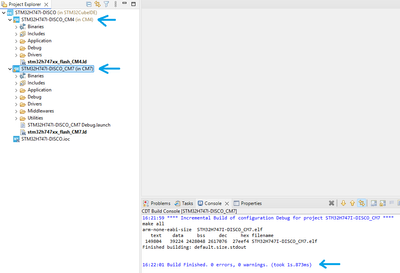

I started a project with a TouchGFX designer and tried with a TBS board (STM32H747-DISCO) and didn't face any issue when using .project.
It already contains both projects CM4 and CM7 when you open it:
Both projects (CM4 and CM7) compile fine.
THANKS!
had a try use TBS board (STM32H747-DISCO), to create a new project! can pass compiling!and TouchGFX designer generated code OK!  total project use M7, but the project is personal style instead of MX and touchGFX style,when read code feeling very hard to understand!

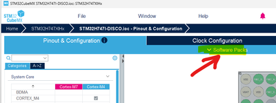

from MX access to create a new project, the MX' select item is

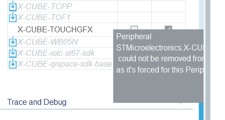

total different, touchGFX can't place under M7,  it be forced to M4!
moreover, many places cannot be reselect. don't know how to utilize M7 by MX, many select items be force under M4, how to do, is there a switch to do, to turn M7 from M4!?

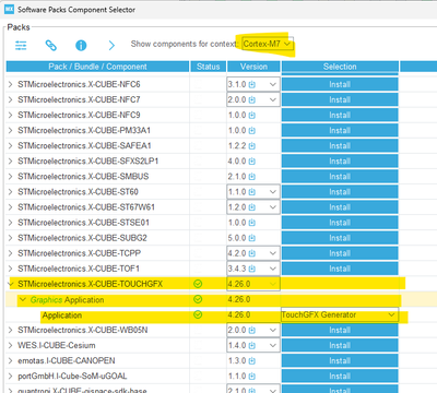

Hello @redstone8415 ,
You have this issue because you haven't selected TouchGFX for Cortex M7 I believe.
