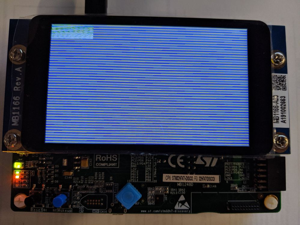

I used the STM32 ST-LINK Utility and downloaded the File "...\My Application\TouchGFX\build\bin\initflash.hex" - the result can be considered in the appendix :(

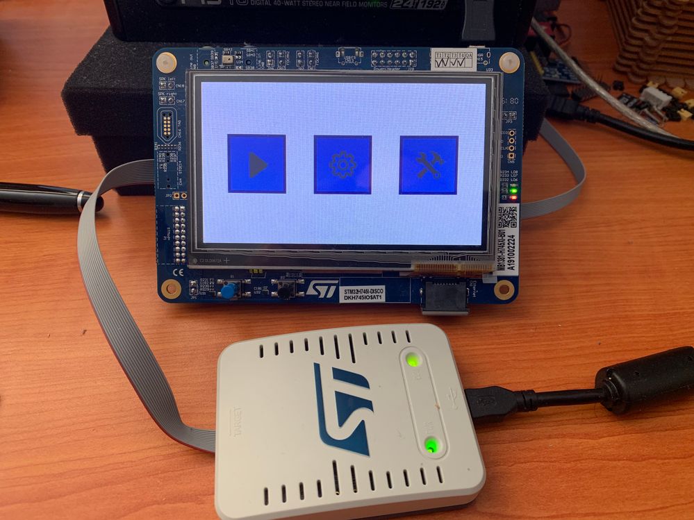

Hi, welcome to STM32. Dual core processors are not yet implemented in STM32CubeIDE. It will come but nobody knows when. I have got a STM32745i-Disco board and I have successfully downloaded a test screen from TochGFX designer. To develop code for both cores you have to use System Worbench (see picture TouchGFX CM7, CM4 blinking led) .
For the STM32H747 I have created a TouchGFX designer project (attached). Try downloading the target.elf file. Building code from command line 'TouchGFX 4.10.0 Environment'. Change folder to TouchGFX and run 'make -f ../gcc/Makefile -j8' and 'make -f ../gcc/Makefile -j8 clean'.

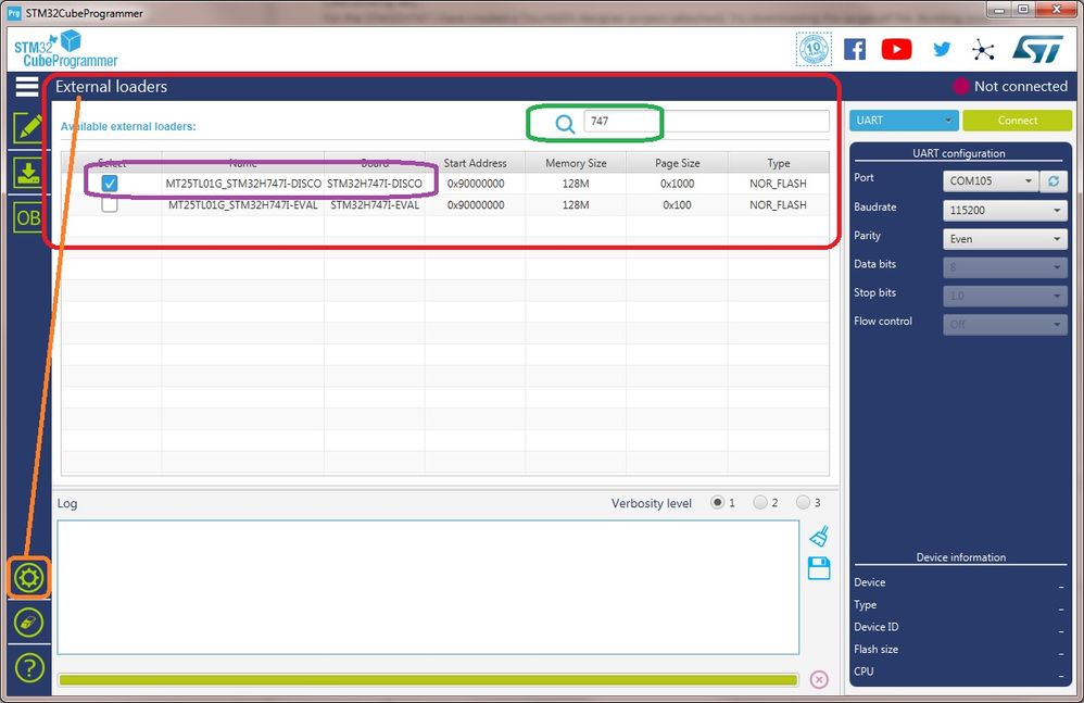

You have an External Loader selected for the onboard QSPI?

Ok, I am able to download the files. Do I always have to download the two files target.hex and intflash.hex? And with which tools can I programm the STM32 can I use STM32CubeIDE?
‎2019-07-25 2:24 PM
One file is the executable code which goes into Internal Flash memory, and one is the imagery data which goes into the External Flash memory.
