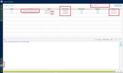

Tips for you (and for all other users) regarding how to know which External loader to use on ST boards.
As it's not easy to find the correct Flash loader in STM32CubeIDE because of the long list, you can use STM32CubeProgrammer tool and go to External loader menu and then type for example in your case H745 in the search bar. The list of the external flash loader will be displayed for all boards available for that MCU part number. The list will be shortened and you can identify the flash loader either by the start address or by its name.. :SofLit_1-1726651737685.png
Hope it helps.
