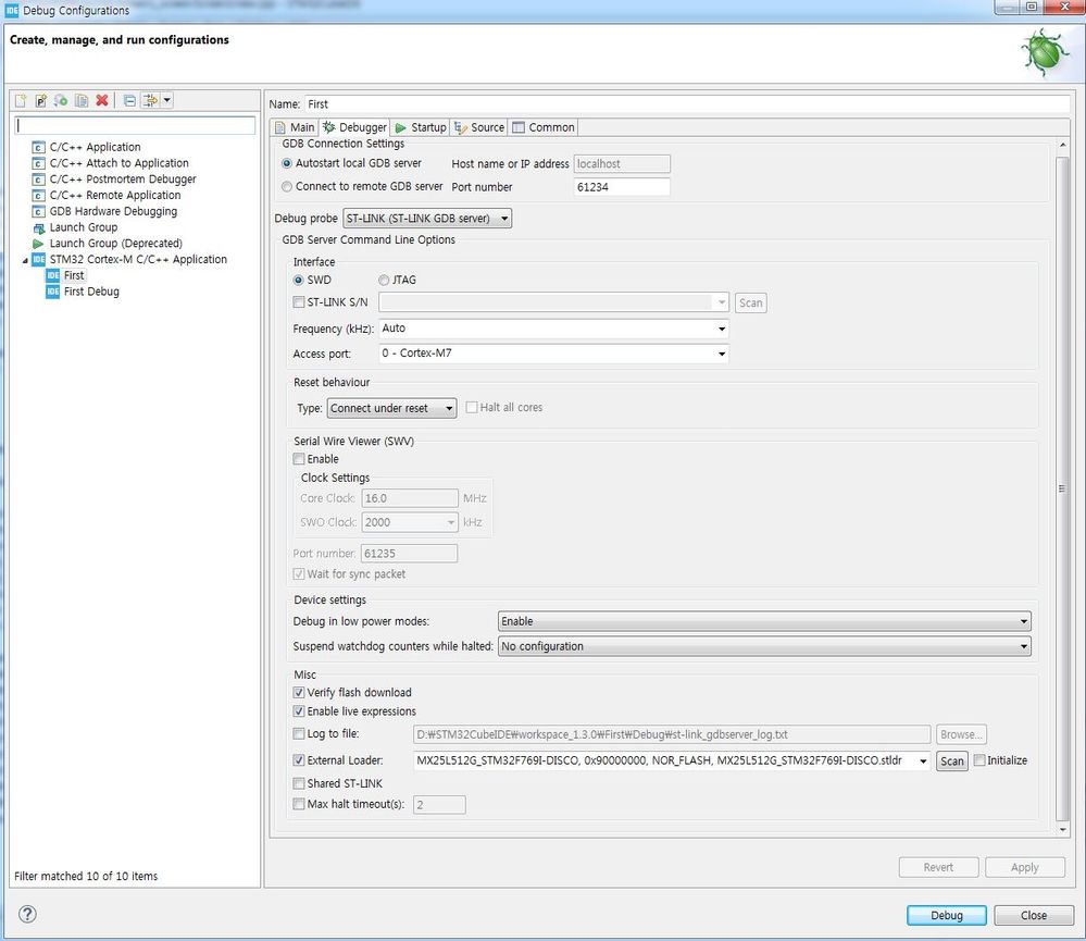

I have a question.
I made progress with reference to this YouTube video.
(https://www.youtube.com/watch?v=12KXreXaLp0)
After creating the basic template stm32f 769-disc using TouchGFX designer 4.1.3.0, the .ioc file was created and the stm32cubeide 1.3.0 stm32f 769-disc project was covered. After the basic setting (copying flag.id and adding BSP folder), there was no problem in debugging, but I am not sure whether it is qspi or LTDC, but stm32f769i-disc kit shows only black screen. The attached file is my project file. We would appreciate it if you could tell us how to solve it.

Martin KJELDSEN
Chief III
A few questions:
1) You say the .ioc file was "created", but V3.0.0 of the application template for that board already one. Did you mean to say created?
2) What's the application doing if you debug? You may be missing the external flashloader in your debugger settings.
/Martin

1)TouchGFX template version used 3.0.1v.
I worked with the .ioc file created after "generate code".​
2. In the same case, the settings were made as in the photo.

이병석.1
Thank you. It's settled. It's not a video, but it works right away as I set it's a target.
