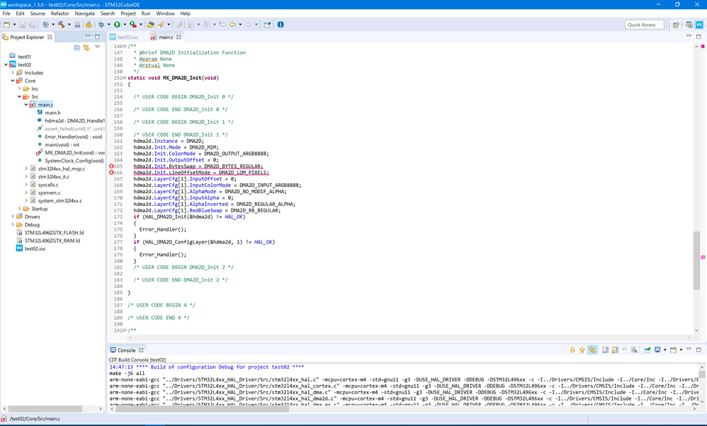

I tried to add DMA2D to a successful generated and built L496 based CubeIDE\TouchGFX project .

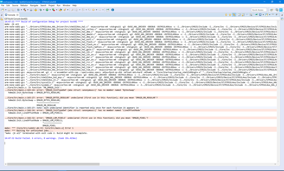

I get compilation error regarding two elements in the DMA2D initialization function as below:
../Core/Src/main.c: In function 'MX_DMA2D_Init':
../Core/Src/main.c:286:14: error: 'DMA2D_InitTypeDef {aka struct <anonymous>}' has no member named 'BytesSwap'
  hdma2d.Init.BytesSwap = DMA2D_BYTES_REGULAR;
../Core/Src/main.c:286:27: error: 'DMA2D_BYTES_REGULAR' undeclared (first use in this function); did you mean 'DMA2D_RB_REGULAR'?
              DMA2D_RB_REGULAR
../Core/Src/main.c:286:27: note: each undeclared identifier is reported only once for each function it appears in
../Core/Src/main.c:287:14: error: 'DMA2D_InitTypeDef {aka struct <anonymous>}' has no member named 'LineOffsetMode'
  hdma2d.Init.LineOffsetMode = DMA2D_LOM_PIXELS;
../Core/Src/main.c:287:32: error: 'DMA2D_LOM_PIXELS' undeclared (first use in this function); did you mean 'DMA2D_PIXEL'?
                DMA2D_PIXEL
I see that if I take a a project that was created from a V3 AT those initialization are not there and also do not generated by CubeMX if I try to regenerate the code.
Note that my DMA2D bytes swap and line offset mode is the same as in the AT:
Any idea how to handle this?

Here is what I done:
Start new stm32 project > Search for STM32L496ZG and select the STM32L496ZGTx reference > Name my project test02 and use default location (under user folder), C++, Executable, STM32Cube > Firmware Package: STM32Cube FW_L4 v1.15.1, Copy only the necessary library files then finish.
In the MX perspective, I just activate DMA2D (Multimedia tab) without more configuration. Code is generated without any error. Building it rise errors:

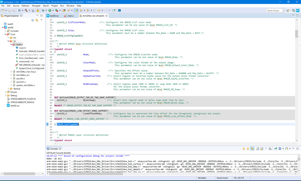

I tried with v1.15.1 and v1.15.0 and got the same issue. It seems to be a generation error from cubeMX, these wrong code lines are generated for a L4 series (my case) but are only compatible with L4+ series
