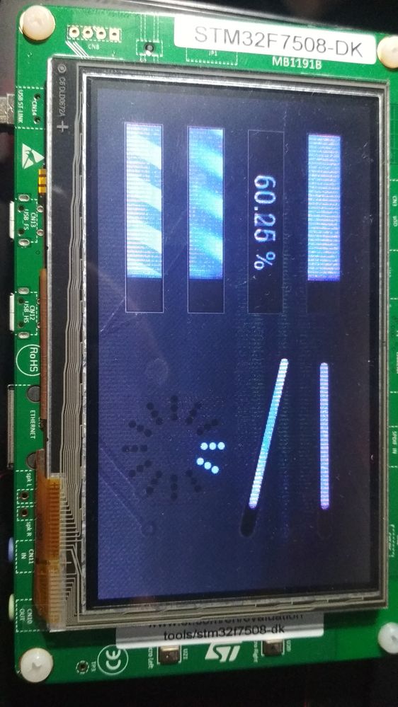

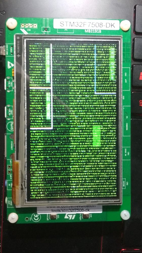

I am starting with the 508 Disco board and I have tried to build some applications with succes, but then the display shows them wrong, I have tried a few default apps from TouchGFX, one made by miself with TGFX, and another one with BSP libraries and CubeIDE.
The results are that the display does not render them correctly, the colors, some lines...
Here I attach two pictures, the first one from one TGFX default template, and the other one from the BSP drivers, I also attach you the code needed for the BSP, appart from the initialisation code generated with Cube selecting the 508Disco board and the default pin initialization for the board

Have you tried using the F750-DISCO Application Template available on TouchGFX Designer ?
/Alexandre
Yes, when I create the TGFX project, I select the F750_Disco Template
Thanks
Could you specify all the steps you did so that we can reproduce on our side and see if we have the same issue on our side ?
For instance :
  • Open TouchGFX 4.14
  • Select Application Template F750-DISCO v3.0.0
  • Select the progress bar example
  • Generate code
  • Run Simulator
/Alexandre
Hi, I found that there was a lack of power feeding the board, now I have the TGFX applications working correctly with the new supply, but, the project with STM32CubeIDE, and uploaded with Cube Programmer, keeps the same as the picture above.
The settings for the Cube Programmer are:
Port :SWD
Freq:4000
Mode:Normal
Access Port:0
Reset Mode:Soft(I have also tried Hard without success)
Shared:Disabled
And the Cube IDE with the template of the 508Disco Board
Thank you
The default values should be fine.
If you use the F750-DK Application Template, this should work using CubeIDE. It was tested many times.
Please as mentioned in the previous message, provide the steps you did.
You could try and delete the STM32CubeIDE/ folder and regenerate it with CubeMX. Don't forget to save your .ld files somewhere before deletion so that you can put them back in the newly generated folder.
