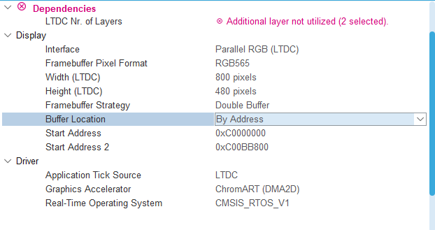

How to config 2 layers LTDC by useing CUBEMX for TOUCHGFX? CUBEMX warning me additiona layer layer not utilized when i config LTDC 2 layers

TouchGFX doesn't use the second layer, that's all the message implies. You can use it for something else if you want, but TouchGFX uses Layer 1. Unfortunately we cannot do just a "warning" in the ui, but when you generate code CubeMX will ask you if you're okay with the active "warning" before generating code.

thx for the answer ,then i still have a question,​ if touchgfx uses layer 1 which is the bottom layer on lcd,then i show a picture on top layer,that will override what touchgfx shows,is there way to make touchgfx shows on top layer?
is there any good solution​ for camera and touchgfx woring at same time,and the touchgfx will cover a part of the camera video?
There's no official solution. But you can reconfigure your application to use the second layer for TouchGFX and use the first one for Camera. I know i've assissted someone on this community before with that (except the layer order was reversed compared to what you're doing). Please have a look through this community and see if you can find it.

My needs are:
  • Camera image as a background, and above it some GUI indicators that may be changing.
So far I can only see the camera image or the touchgfx, but no way to see both at the same time. Is there somehow that touchgfx background is transparent?
