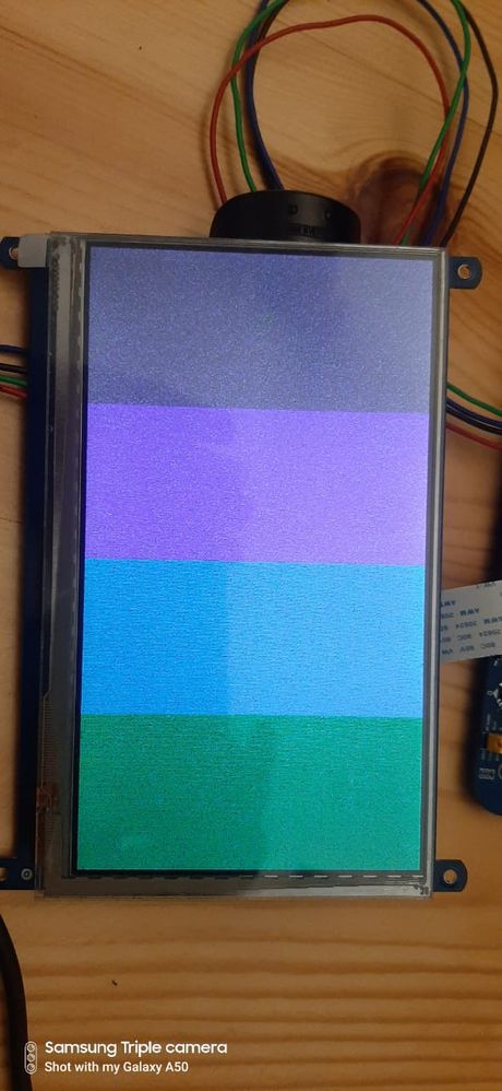

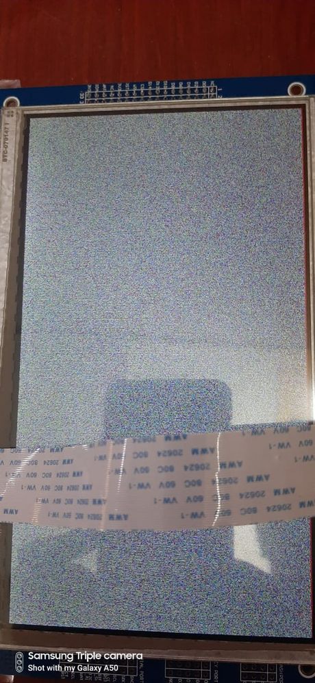

Yes...., It's work TouchGFX, But if one switch OFF and ON the controller again display showing some color's.
go to .ioc file and change LTDC --> Layer Setting --> color frame buffer start address : 0xD0000000, change to 0xC0000000,(this time display show Whit color) and again change 0xD0000000 or this all done in main.c file " pLayerCfg.FBStartAdress = 0xD0000000;" (Change run the code and make some changes and run the code after some attempts it will work) some thing do like this

switch OFF the controller again start from first.
Why some time it will work some time not work,
Where i need check? where i am make mistakes?

‎2021-06-15 10:35 PM
Display IC have some selftest commands and maybe when init sequence is bad show selftest and with this setup all LTDC is ignored, too LTDC address is overwrited with TouchGFX HAL then must be setup properly on two places .
