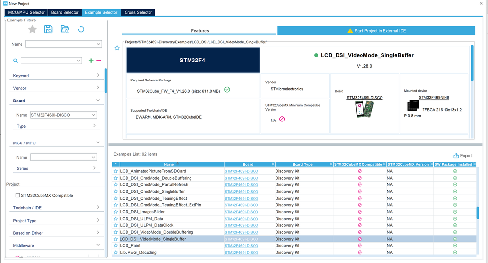

Hello @RobNewbury ,
Sorry for the late response. I can see our good friends @MM..1 and @Tesla DeLorean have provided wonderful and useful information already.
Just wanted to update on this issue that we were not able to measure similar parameters as you did. However, there are examples for setting up the board for DSI Video mode both with single and double framebuffer. You can access them from opening STM32CubeMX -> New Project -> Example Selector and searching for STM32F469I-DISCO under the Board section. You might need to modify some settings to fit your case, but I think it's a good base to start your project on.
STM32CubeMX Example SelectorSTM32CubeMX Example Selector
I hope this helps you
Mohammad MORADI
Thanks Mohammad, this is great I hadn't previously spotted that DSI video mode example in STM32CubeMX which I have now looked at and I can confirm that it runs fine on my (unmodified) STM32F469I-DISCO board.
If I connect my own circular display in place of the built in display then without doing anything else I see some scrambled lines grouped around the centre of the dispay. This is good because as you say I need to modify the example code to configure for my display. This is a whole lot more than I was getting previously when I was following the TouchGFX documentation scenario for MIPI-DSI Video mode https://support.touchgfx.com/docs/development/touchgfx-hal-development/scenarios/scenarios-dsi-video-mode#dsihost-ltdc-initialization-sequence
I will continue to correctly configure my display using the example that you have highlighted and then I will try to understand how I can use TouchGFX for future applications.
I will keep this thread open and add an update when I have achieved my aim.
