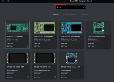

‎2024-11-29 7:43 AM - edited ‎2024-11-29 9:13 AM
Unfortunately, there is no TouchGFX Board Setup for STM32F413 disco available on TouchGFX designer.
Only STM32F412 Discovery is available as template.
The available TouchGFX designer templates for F4 boards:
See also this thread: https://community.st.com/t5/stm32-mcus-touchgfx-and-gui/touchgfx-on-stm32f413h-disco-board/m-p/207376
‎2024-11-29 7:49 AM - last edited on ‎2024-11-29 7:53 AM by mƎALLEm
@SofLit wrote:
Only STM32F413 disco is supported.
See this thread: https://community.st.com/t5/stm32-mcus-touchgfx-and-gui/touchgfx-on-stm32f413h-disco-board/m-p/207376
You mean STM32F413H Disco ?
https://www.st.com/en/evaluation-tools/32f413hdiscovery.html
@HAnh here's a thread on setting up for a custom board:
‎2024-11-29 7:54 AM - edited ‎2024-11-29 7:54 AM
Sorry I meant 412G DISCO. I've edited my comment.
