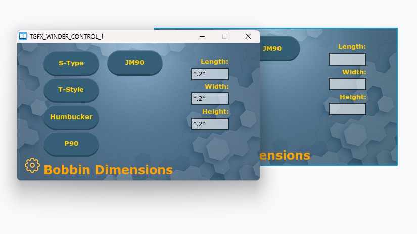

Hi all.  I'm trying to display local floating point variable data via a button click in text area fields on my TouchGFX project screen.
I seem to be having an issue.   It appears that the fields are being populated with the format specifier that preceeds the variable in my code.  Here is my button function:
void main_screenView::s_type_bobbin_btn_click()
    // Test constant, floating-point variables for bobbin dimensions
    const float bobbin_length = 12.51;
    const float bobbin_width = 7.36;
    const float bobbin_height = 3.88;
    // Convert the float values to strings and store them in the buffers
    Unicode::snprintf(bobbin_length_data_areaBuffer, sizeof(bobbin_length_data_areaBuffer), "%.2f", bobbin_length);
    bobbin_length_data_area.invalidate();
    Unicode::snprintf(bobbin_width_data_areaBuffer, sizeof(bobbin_width_data_areaBuffer), "%.2f", bobbin_width);
    bobbin_width_data_area.invalidate();
    Unicode::snprintf(bobbin_height_data_areaBuffer, sizeof(bobbin_height_data_areaBuffer), "%.2f", bobbin_height);
    bobbin_height_data_area.invalidate();
Here is the result of the button click (using the asterisk as a fallback character):
I have tried multiple ways to try to correct this behaviour without success.  If anyone can shine a light on my errors/issues, I would be exteremely appreciative.  Thanks

Use snprintfFloat instead of snprintf
Refer to: https://support.touchgfx.com/docs/api/classes/classtouchgfx_1_1_unicode

Yay! So simple.  Thanks for the super quick response! Fixed it.
