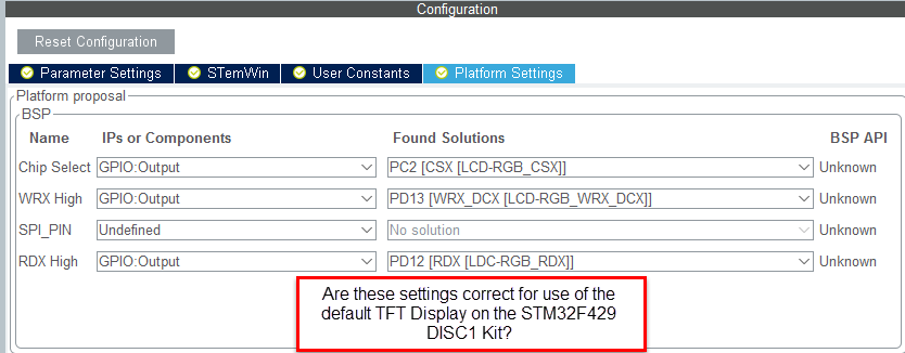

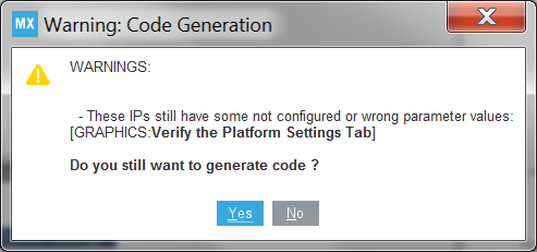

Hi. The integration between TouchGFX and CubeMX 5.0 is quite complex. Recent attempt of a combo project is able to compile without errors on IAR but the GUI generated with TouchGFX results in a blank TFT display on this kit. Guessing something to do with the LCD display and will attempt to debug.
CubeMX is complaining about the Platform Settings so is the issue with the SPI_PIN?

can someone post a similar solution for the STM32F429 DISC1 target?
There are many variables that can derail a working solution.
Thanks!
