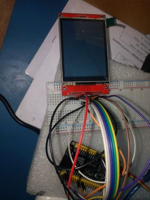

I have created a ui to that i am able to upload on the custom board(STM32H750VBT6) which i can successfully Debugging using IDE but display is empty.I dont know where I am wrong.

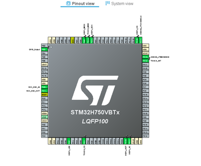

I attached the library that I am using below.I have taken library from this GitHub
with this pinout

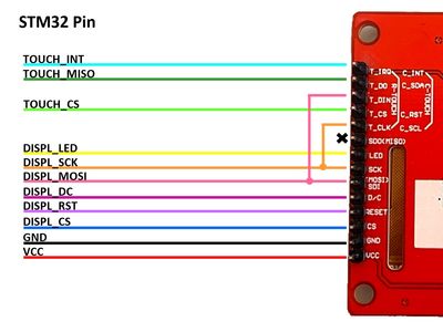

WeAct Studio STM32H750VBT6-LCD Demo Board:-
https://stm32-base.org/boards/STM32H750VBT6-STM32H7XX-M.html
2.8 inch SPI Screen Module TFT Interface 240 x 320 without Touch:-
https://robu.in/product/2-8-inch-spi-screen-module-tft-interface-240-x-320-without-touch
pin connection:-
DISPL_LED = PA7
TOUCH_CS = PB1
DISPL_RST = PB10
DISPL_DC = PB11
TOUCH_INT = PA12
TOUCH_INT_EXTI_IRQn EXTI15_10_IRQn
DISPL_CS = PA15
DISPL_SCK = PB3
TOUCH_MISO = PB4
DISPL_MOSI = PB5
I attached zip file of the project bellow

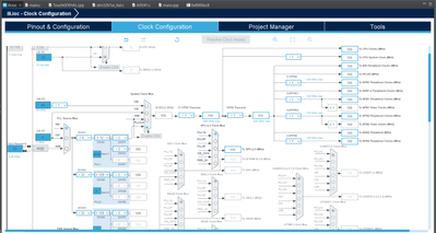

Same code for different chip sounds risky. If you have a different mcu, most likely some libraries are different.
Also, you do not mention clock frequency. Using the wrong timings could be the reason why you are not able to transfer data.

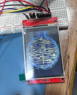

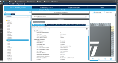

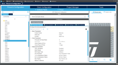

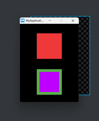

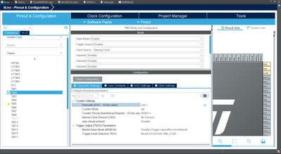

I triyed different code with your suggestion and I was able to display TouchGFX graphics but it is distorted.
SPI1
TIM
Clock Configuration
O/P 
I try changing above configration but it still the same. I will attach zip file of project below.
Hello @Kai_Satone ,
That is a great step forward already!

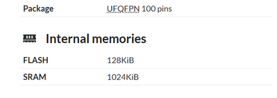

I see that your asset is placed by default in external flash. Could you try to place it in internal flash to see how it behaves?
Also, could you try to display a box (or another element that doesn't need an asset)?
Regards,

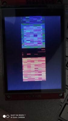

@GaetanGodart
I have checked both ways but the internal flash is only 128 KiB and after enabling TouchGFX, the file size is more than the internal flash so I can't test the method.
I also use this method.""Also, could you try to display a box (or another element that doesn't need an asset)?"" but I got the same result.
TouchGFX UI
O/P I got 
Hello @Kai_Satone ,
This could be a communication issue.
Could you check with an oscilloscope or logic analyzer your SPI communication protocole?
Verify that the timings are correct and that the commands and data are as expected?
Regards,
Gaetan Godart
