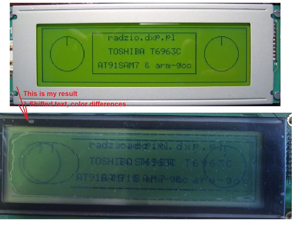

‎2020-01-31 12:39 AM
Sorry for not putting the model.
It is for the T6963C model.
I have already modified the code of http://en.radzio.dxp.pl/t6963/ and it does not work correctly.
Text and drawings on the LCD are messy.
Is there no way to get a T6963C functional library for STM32?

‎2020-01-31 1:28 AM
Looks relatively easy to port. I have worked with less/worse.
Just start from the base - first verify all hardware connections, then the low-level read and write access, and later high-level functions for drawing.
One step a time.
‎2020-01-31 1:55 AM
OK so if you have it half-working, debug as usually. Check all hardware connections (e.g. bad solder joints, bad connections, shorts, swapped pins), check if your assumptions in software are correct (e.g. the 6-column vs. 8-column mode of the controller, clock/crystal of controller versus timing), check timing (observe by oscilloscope and compare to datasheet).
Try to qualify "messy" and think about it in terms of possible sources (e.g. "one of 6/8 columnts does not light up - can't this be problem with one of the databits being stuck to 0?)
‎2020-01-31 2:24 AM
Hi and thanks for your answer
I have checked the hardware correctly.
I have verified PIN to PIN that the signals arrive correctly on the LCD.
I also checked the code in case there was an error in any bit but I can't find anything to prove the error.
This is my result:
