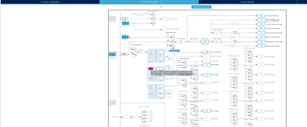

your PLLSAI1 is not set right.
You're generating a 25MHz pixel clock. If you're using the F746-Disco board then you want something like 9.6MHz or thereabout.. I think the minimum is 8 and max is 12..
Try setting the /R to 6 and *N to 57 ish...

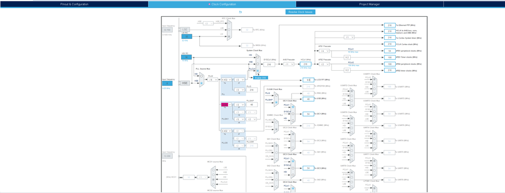

You are right, the timing on the LCD-TFT is way too high. I've been messing with this timing, *N on PLLSAI1 cannot be set to less than 100 without cubemx barking at me about it. I ignored the errors and what do you know! it works!
I have attached some screenshots of the "errors" that cubemx throws when I change *N and /R values.
I had a whole host of problems with just setting the values. Cube would not update the values and selecting the dropdown box was a huge pain.
Are you writing in the field? I thought it was just an output value :)
You can type into the LCD TFT field and CubeMX will attempt to back calculate all of the divisors and multipliers. It is hit or miss. In this case I manually found the proper values because CubeMX refuses to accept the values that work.
