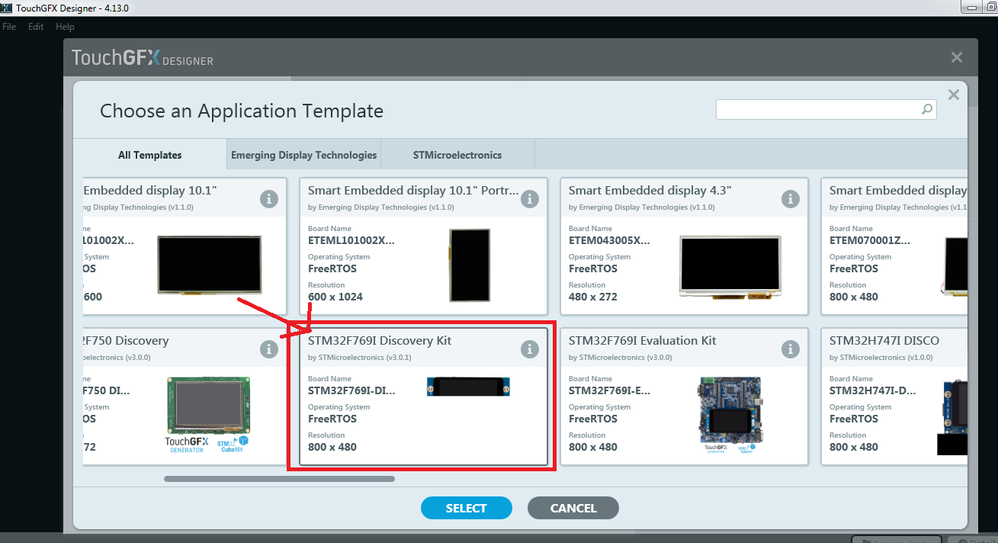

Why don't you like this ?
Open TouchGFX -> Change Application Template -> Choose STM32F769I-DISCO Kit .. and Draw something.
Run Simulator then Run Target...
That will automatically generate setting of STM32CubeMX which you are manually doing.
Hope this helps..

2020-05-22 11:27 AM
Hello Karan,
thank you! I only looked at the "online" section of touchgfx and this was nearly empty. Now I can modify the ioc, however, the created IAR v8 project file is for a newer IAR version than 8.30.
After manualy editing the ewp file, I can compile, upload and debug.
Thanks again!
