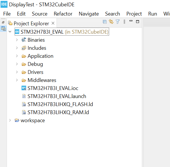

I am using the STM32H7B3I-EVAL, which includes a touch screen that uses the TouchGFX application. I am trying to do its tutorials, which includes modifying the code in the STM32CubeIDE. However, when I do, the file structure is different in my computer's file explorer compared to what is shown in the STM32CubeIDE project explorer.
For example, the TouchGFX folder in my File Explorer is not present in the IDE project explorer.
What causes this and what can be done to fix it?

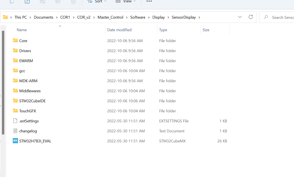

"The level I'm looking at (ADC_Display) does not match what's in the project explorer. "
Again, that's is normal because STM32CubeIDE as a configuration view of it's root folder that is STM32CubeIDE\
"I went into one of the subfolders (ADC_Display/STM32CubeIDE) and I found a matching file directory!"
Yes and that is what I already explain to you yesterday and just above.
"Now, it still poses an issue because this project folder is missing things like the header files and such. Does this information help at all? The .project and .cproject should be in the ADC_Display folder, not ADC_Display/STM32CubeIDE folder, correct?"

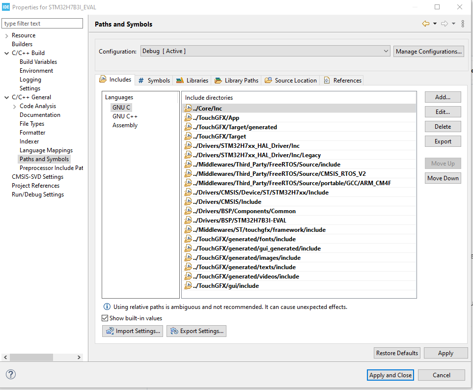

No your project generated has no issue. All sources and header file are located on folder above \STM32CubeIDE, like ..\Core or ..\TouchGFX.
Yes these informations are mandatory and STM32CubeIDE is able to found them because the path of the project are correctly configured (see following picture)
These folder path configuration are also into the .cproject file.

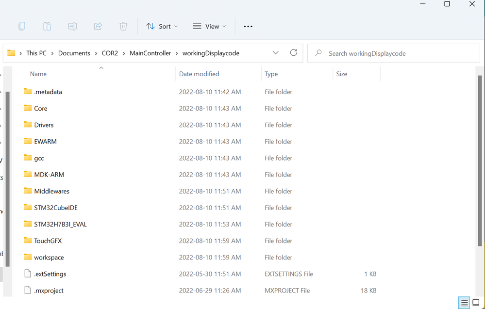

There's something I clearly don't understand about how these projects define the files for the workspace. I had a previously working project folder. I imported it to another folder (because I wanted to organize my work), and now the previous project folder does not work at all.
I need a solution that I can understand as to why the project explorer is so incomplete and why it's now causing my projects to not build.

For your problem it is clear that when you imported your original project into a new location you probably broke the project links. How did you do this import, manually ?
Can you check in the STM32CubeIDE folder (from your file explorer) that it contains the files:
.cproject and .project?
It is also strange that all your directories are in the same directory as the .metadata which is used for the configuration of the Eclipse workspace?

- I did import it manually. I copy and pasted the entire folder (including the .metadata) into a new folder.
- I looked in the folders and I only see .project. I do not see .cproject anywhere.

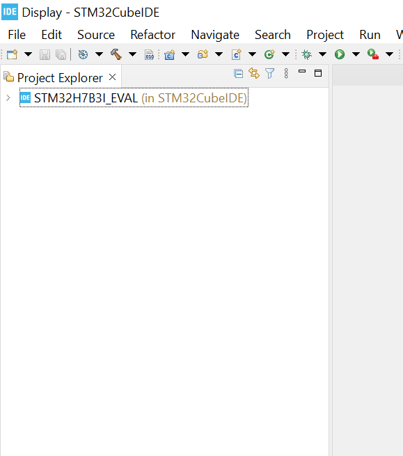

Also, I tried creating a new TouchGFX project and I'm running into a similar problem as before. The project explorer files are incomplete. It is only showing the files in the .ioc executable. Why can I not see Core, Drivers, EWARM, gcc, MDK-ARM, Middlewares, STM32CubeIDE, TouchGFX?

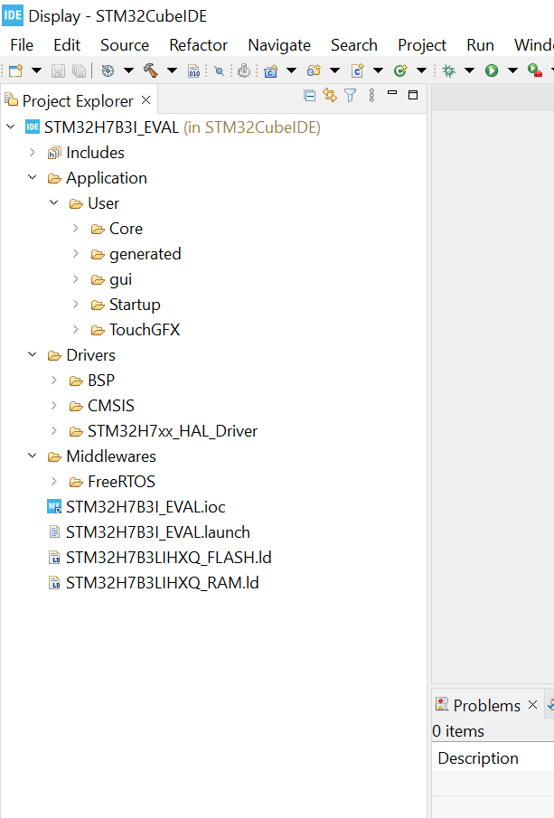

In your new TouchGFX screen capture, the project is not incomplete, it is just folding.
In STM32CudeIDE project explorer window, you have to unfold the project to see all the files (the arrow on the left of the project name) Core, Drivers, TouchGFX and friend.....
