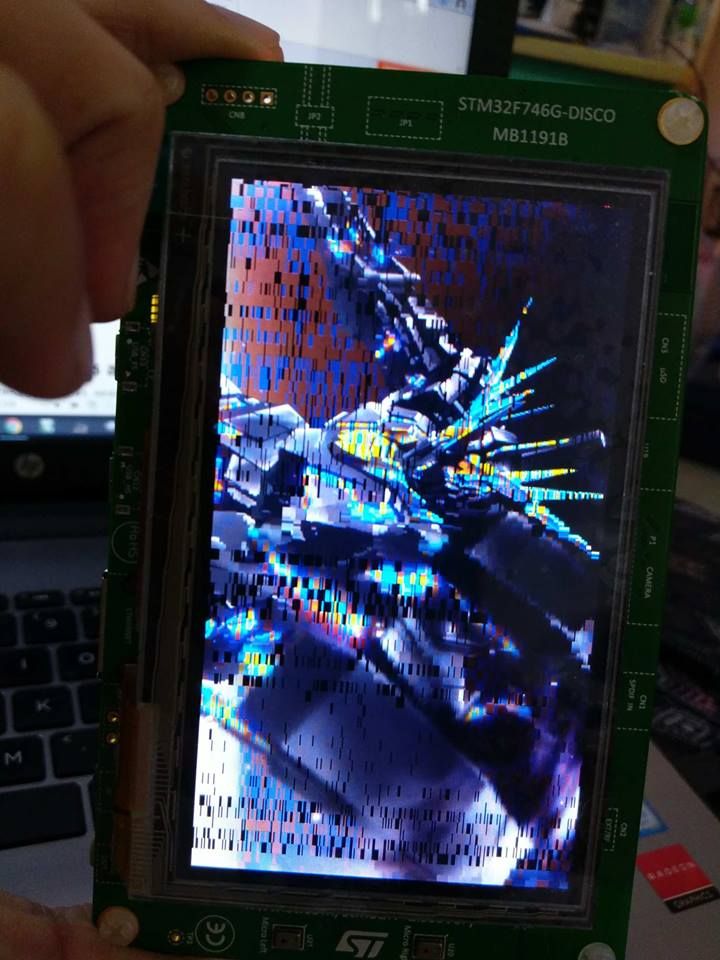

I am trying to use the STemWin 5.40 in the STM32F7Cube 1.8 pack with my F746-DISCO. The basic display works fine until I tried to display an .jpg image on the LCD. The original image is:
While the display on the LCD is:
I used the Memory device to store the code like this:
/* My code begins */
GUI_MEMDEV_Handle GUImem;
BSP_SDRAM_Init(); /* Initializes the SDRAM device */ __HAL_RCC_CRC_CLK_ENABLE(); GUI_Init(); GUI_Clear(); GUI_SelectLayer(1); GUImem = GUI_MEMDEV_Create(0, 0, 480, 272); GUI_MEMDEV_Select(GUImem); GUI_JPEG_Draw(_acgundam1, sizeof(_acgundam1), 0, 0); GUI_DrawLine(0, 0, 99, 99); GUI_MEMDEV_Select(0); GUI_SelectLayer(0); GUI_MEMDEV_CopyToLCD(GUImem);/* My code ends */
Can anyone gives me a hint or a way to fix this error? Or may be some references is fine too. Thank you very much!

‎2018-01-14 1:06 PM
did you check the polarity and phase of your clock signal ?

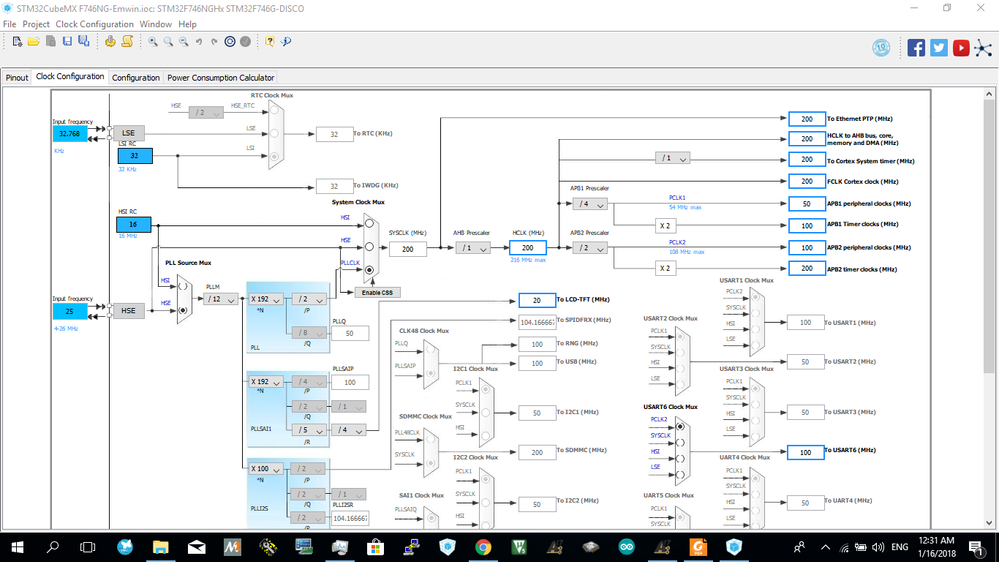

‎2018-01-15 10:31 AM
Hi TJ,
Yes I did, this is my clock config with the CubeMX
‎2018-01-15 4:15 PM
are you using 5-6-5 format ?
did you check the dot rate ?
20MHz to the LCD seems low.
Maybe someone from the ST team will know about an example to use the STemWin 5.40 in the STM32F7Cube 1.8 pack with the F746-DISCO

‎2018-01-16 3:55 PM
there are several physical requirements for an LCD.
the Dot rate must be closeish and the phase and polarity correct.
the data length 16bit/18bit/24bit must be set correctly for the connections you have, that set the colour format.
Thats usually 16 bit 5:6:5 = R:G:B
