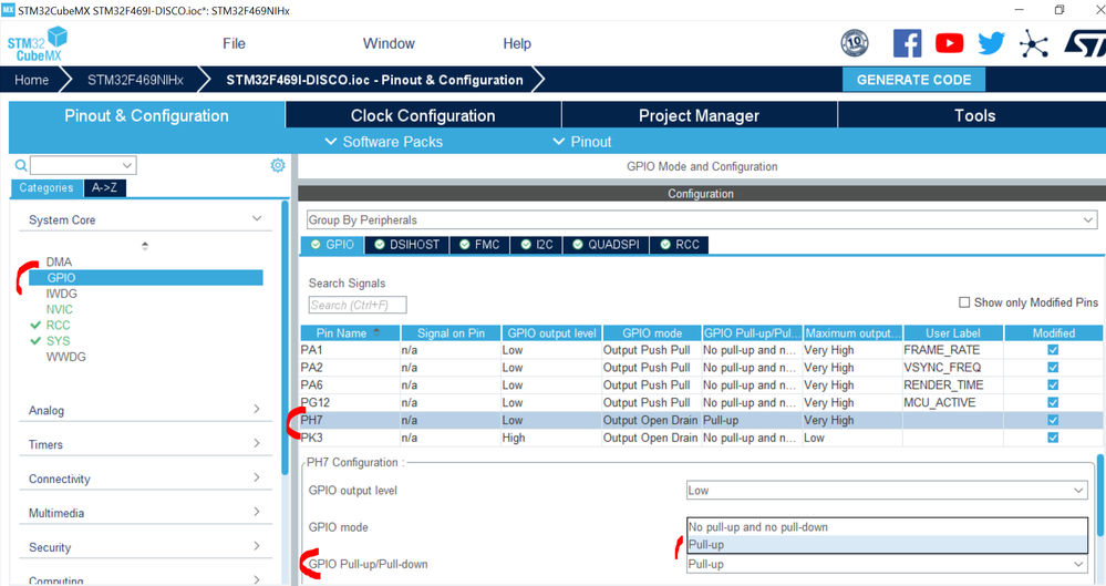

[SOLVED] STM32F469I-Disco and TouchGfx 4.20.0. I bought STM32F469IDisco. Version MB1189-F469NIH6-B08-A222300689. When I try start new project with TouchGFX, result is black screen.
SPrik
I tried both "Run Target" from TouchGFX Designer, and Cube IDE (Cube MX) compile / debug result is black screen. Compile, debug and run is without errors.

Hello Ebby,
I was told that the difference with the latest revision B-08 is a change on the Touch Display circuit, where an out chip (out of microcontroller) pull-up resistor was removed from LCD_Reset Pin. This pin is connected to PH7. This is pointed in the User Manual UM1932.
Could you try to activate the internal pull up at this pin in STM32CubeMX as in the picture below ? Cannot guarantee it works as I do not have the board with me to test it.
/Romain
SPrik
Debug from stm32469i_discovery_ts.c file, function BSP_TS_Init
I2C_address = 112 = 0x70
PH7 - with or without PULL UP - not working.
I found, function BSP_TS_INIT return error 0x03 = TS_DEVICE_NOT_FOUND
Important this funtion is calling approx 15 sec after program debug started.

EmbDev
Senior
You need to checkout the B08 branch: https://github.com/RTwTools/STM32F469I-Discovery/tree/feature/B08-nt35510
The main branch is the default app for the older display.
You can see the required changes in this commit: https://github.com/RTwTools/STM32F469I-Discovery/commit/26085432aa213f7dd75b59c06e9b40c444992ffa
