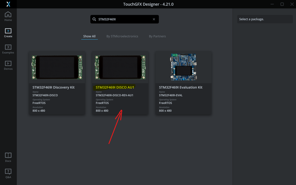

A new TBS is now available on TouchGFX Designer 4.21.0 for this STM32F469I-Disco $AU1 revision (B08)
It should resolve the issue with the black screen.

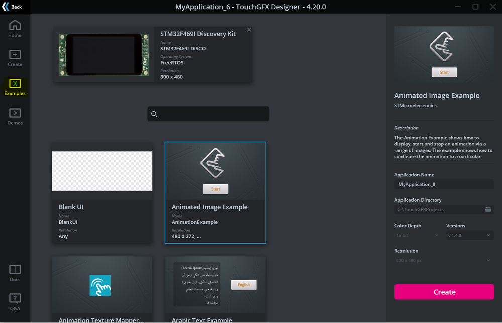

Simply step by step:
1. Start TouchGFx 4.20.0
2. Click on Example – select Animated Image
3. Click on Select Board
4. Select STM32F469i Discovery Kit
5. Click On Generate Code
6. Log – Finished with Done – no errors
7. Click on Run Simulator – working witout problems
8. Click On Run Target- compile without problems, finish with Done
9. Unplug / Plug – Screen remain black.

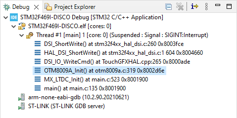

21. The first problem is in :
When system call „MX_LTDC_Init();“
Call stack:
while ((hdsi->Instance->GPSR & DSI_GPSR_CMDFE) == 0U)
 /* Check for the Timeout */
 if ((HAL_GetTick() - tickstart) > DSI_TIMEOUT_VALUE)
 return HAL_TIMEOUT;
  This function „MX_LTDC_Init�? take almost 2min time.

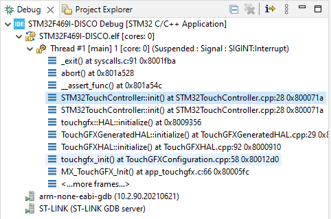

And next:
System is freezing in:
(STM32TouchController.cpp)
void STM32TouchController::init()
 * Initialize touch controller and driver
 if (BSP_TS_Init(800, 480) == TS_OK)
 bsp_ts_initialized = true;
 assert(bsp_ts_initialized);
Its invoke:
(syscalls.c)
void _exit (int status)
 _kill(status, -1);
 while (1) {} /* Make sure we hang here */
Call stack:

Ebby
I am facing the same issue. I guess this happens with the Rev C boards. Apparently the board has a new screen on it with a new NT35510MH lcd driver but the same old FT6336G touch controller.
As a part of the touch controller initialization,
"I2C1_Read" function in stm32469i_discovery.c calls the "HAL_I2C_Mem_Read" which returns HAL_ERROR
I am not sure what the underlaying issue is.

Hi Ebby,
I have found old LCD - ST Part - B-LCD40-DSI1 in my office. Try to replace mounted LCD on 469i-Discovery with old LCD and everything working. In this time I will continue with configuration new board + old LCD. I hope, that ST remove this problem in new TOUCH-GFX version.
