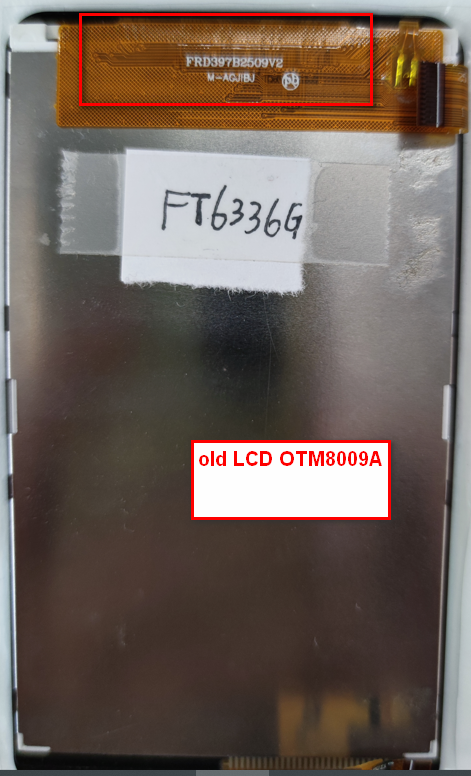

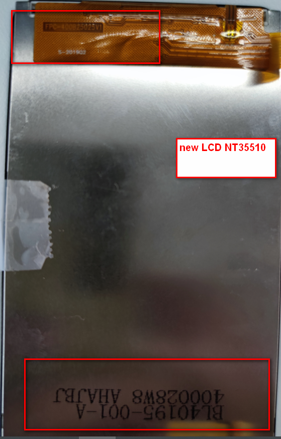

Ebby is right that the board has a new screen on it with a new NT35510MH lcd driver but the same old FT6336G touch controller. but I am not sure if the new LCD has implemented in your STM32F469-DISC board. the driver for old OTM8009A and new NT35510 is different, can you check which LCD is applied in your board?
  1. new LCD NT35510: FPC-400B25025V1
0693W00000WIL93QAH.png 2. old LCD OTM8009A: FRD397B2509V20693W00000WIL9DQAX.png

the originally LCD FRD400B25025-A-CTK is NT35510 driver, so you should used NT35510 driver in code.

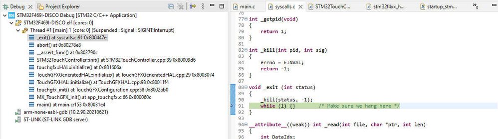

But still is black.
Final debug screen:

I tried make new project.
  1. Start TouchGFX and make new proj. (Select board, Place some buttons on canvas, ...)
  2. Generate code - (simulator working)
  3. Open *.ioc file - CubeMX and generate code
  4. Open CubeIDE
  5. From Drivers/BSP/ Components delete link to OTM8009a/OTM8009a.c
  6. Make new link to NT35510/35510.c
  7. In project files replace all otm8009a by NT35510
  8. Build project => no errors
  9. Debug project. LCD is black.
