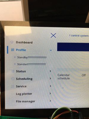

I store "FrontendHeap" to my external SDRAM and in the text appears question mark and when I want to change screen it crashes at specific screen.
I configured my SDRAM

At 0xC0300000 and 0xC0600000 is framebuffers. at Cx0000000 is frontendheap. Maybe someone sees where problem is? When frontend heap is in the internal processor RAM it works fine

What if you set the heap area as non-cacheable in mmu config ?
Br J.T
Unfortunately, same..:sad_but_relieved_face:
JTP1
Lead
Ok.  Can you temporary disable the mmu to see its causing the problems ?
If I disable MPU it does not start at all.
