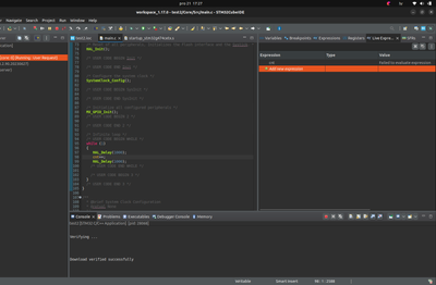

recently I was able to flash a programm on the STM32G474CET3 but I am unable to track Live Variables.
I wrote a simple program that just increases a cnt variable each second.

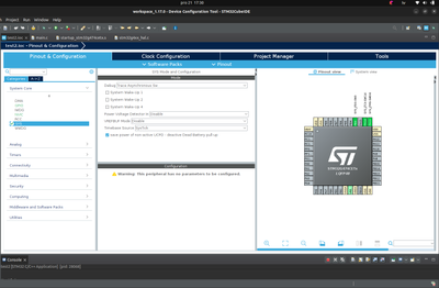

My .ioc configuration:
Every help is appreciated.

Hello richi,
What is the optimisation you are using in STM32CubeIDE?
Can you declare the variable "cnt" as "volatile" and try again please?
