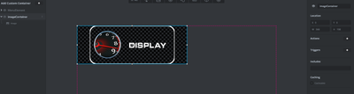

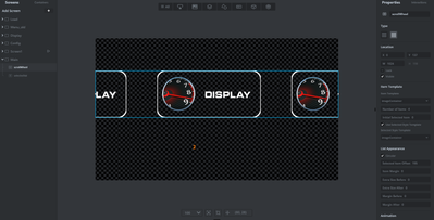

Hello
I want to make a scrollwheel as a menu, when the user clicks on the central image, the window changes.
By following tutorial 4, I managed to adapt it to my needs.
How to do so that when the user clicks on the central image, the window changes. I was thinking of reusing itemIndex via setNumber already used in MenuElement.hpp, but I can't do it.
https://support.touchgfx.com/docs/tutorials/tutorial-04

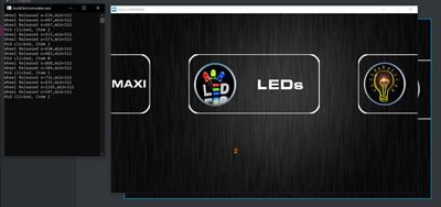

It is not perfect example, just idea how to filter away drag - releases and clicks to other than center item.
Note that touchgfx_printf (simulator console print) needs: #include <touchgfx/Utils.hpp> in view.cpp.
This example is made and tested in 'Scroll Wheel and List' example. It is also attached. you can run simulator.exe from \TouchGFX\build\bin to see what it does. Its made with 4.21.4 but most likely it can be opened also in the later versions.

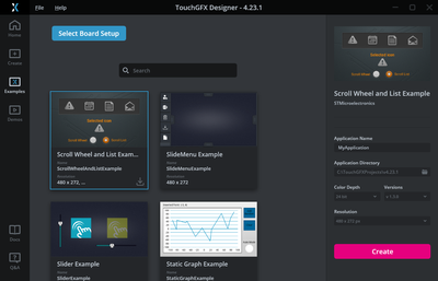

Maybe check also the Scroll Wheel and List example.
With that example you can compare Scroll Wheel and Scroll list behaviour. I think you can achieve your needs much easier with Scroll List. In Scroll Wheel it is difficult separate drag from click, since you get only callback when items are updated.
Or have you allready use Scroll Wheel - mixins - ClickListener- method to get click events from wheel ? With that it is possible.

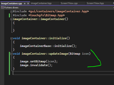

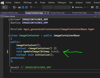

Thank you for your code, I was able to modify it and make it work on a single project but when I integrate it into a more complete project it no longer works. Yet I used the same screen...
I have an error:
" gui/src/main_screen/MainView.cpp: In member function 'virtual void MainView::scrollWheelUpdateItem(imageContainer&, int16_t)':
gui/src/main_screen/MainView.cpp:74:14: error: 'class imageContainer' has no member named 'updateImage'
item.updateImage(Bitmap(BITMAP_ICON00_ID));
gui/src/main_screen/MainView.cpp:77:14: error: 'class imageContainer' has no member named 'updateImage'
item.updateImage(Bitmap(BITMAP_ICON01_ID));
code :
void MainView::scrollWheelUpdateItem(imageContainer& item, int16_t itemIndex)
//item.updateText(itemIndex);
switch (itemIndex)
case 0:
break;
case 1:
break;
case 2:
item.updateImage(Bitmap(BITMAP_ICON02_ID));
break;
case 3:
item.updateImage(Bitmap(BITMAP_ICON03_ID));
break;
NicoEFI
It's Works:grinning_face:
my error
Many thanks
