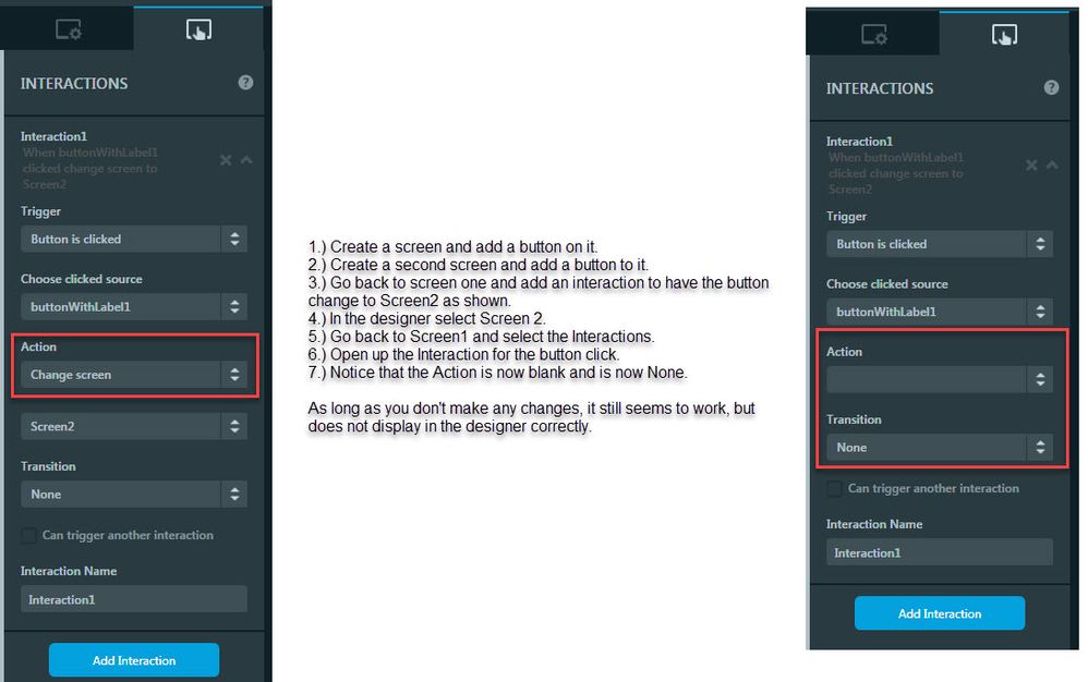

I think I found a bug with 4.12.3 in the Interaction editor...See attached image.0690X00000AtN7UQAV.jpg
Thanks for reporting this. It's already been fixed in the upcoming release 4.13.0 out sometime this december.
/Martin

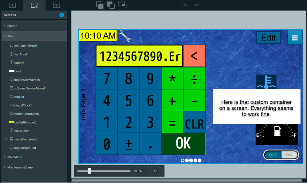

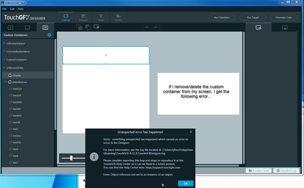

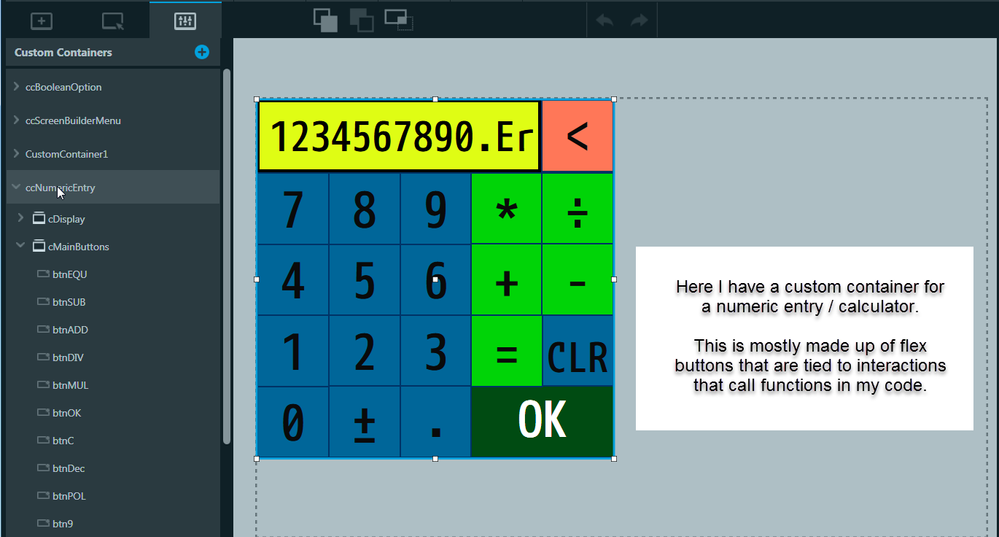

I fond an issue with 4.12.3 when removing/deleting a custom container from a screen...
In this example, it just threw the error and made all the contents of the custom container in the custom container editor blank. But, I have seen it where it just messed up several of the text contents on the Flex Buttons have texts that are changes on some of the buttons.
