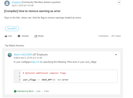

Where can I set the switch "-Wno-error=sequence-point" so that the compiler does not define this warning as an error and aborts?
I don't want to resolve the warning, I want the warning to not stop compiling.

KnarfB
Hope you understand that warning and better resolve it.
Look for a compiler option -Werror and remove that, or add -Wno-error=sequence-point.
See https://gcc.gnu.org/onlinedocs/gcc/Option-Summary.html for all details.
