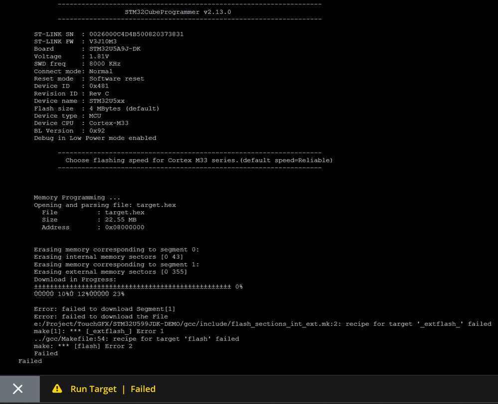

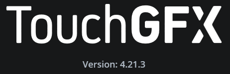

​Hello,
I just encountered "failed to download Segment[1]" error in the middle of tough gfx project downloading.
Demo Board : STM32U5A9J-DK

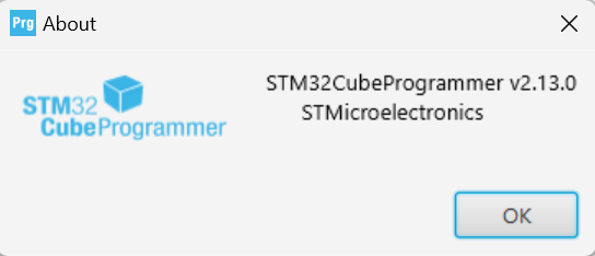

CubeProgrmmer version : 2.13.0
TouchGFX version : 4.21.3
0693W00000bhE8DQAU.png0693W00000bhE9pQAE.pngError message capture

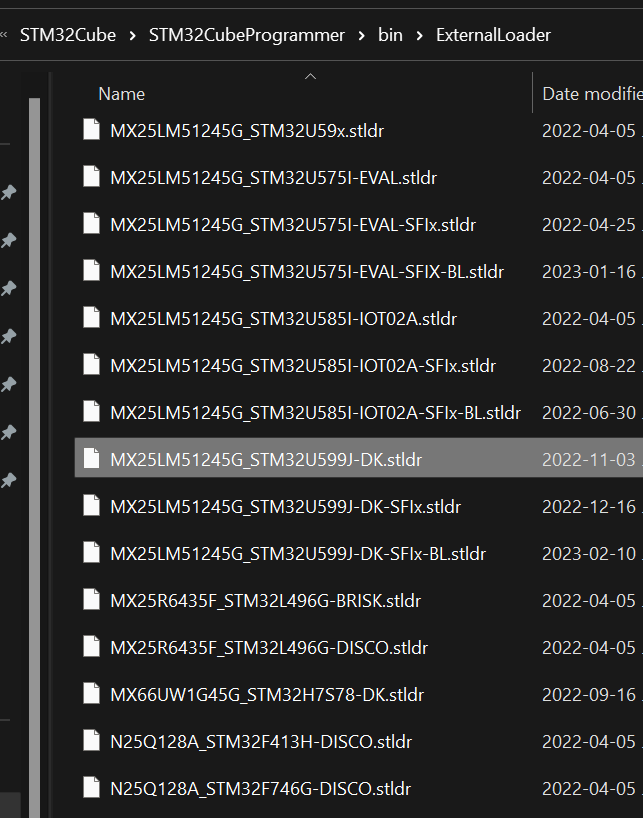

I found that toughgfx is using the Cubeprogrammer tool for binary downloading.
So I searched if the CubeProgrammer has the STM32U5A9J-DK ext-flash binary but can't find for it.
0693W00000bhE9aQAE.pngSeems tool update is needed.
I also found that cuscumized ext-flashing binary can be created with IAR compiler.
https://github.com/STMicroelectronics/stm32-external-loader
But I don't have the IAR :(
So it would be appreciated if to provide the patch file or update the CubeProgrammer ASAP.

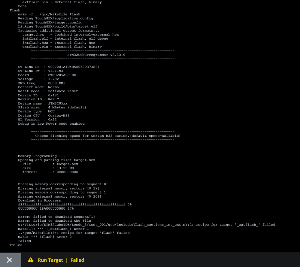

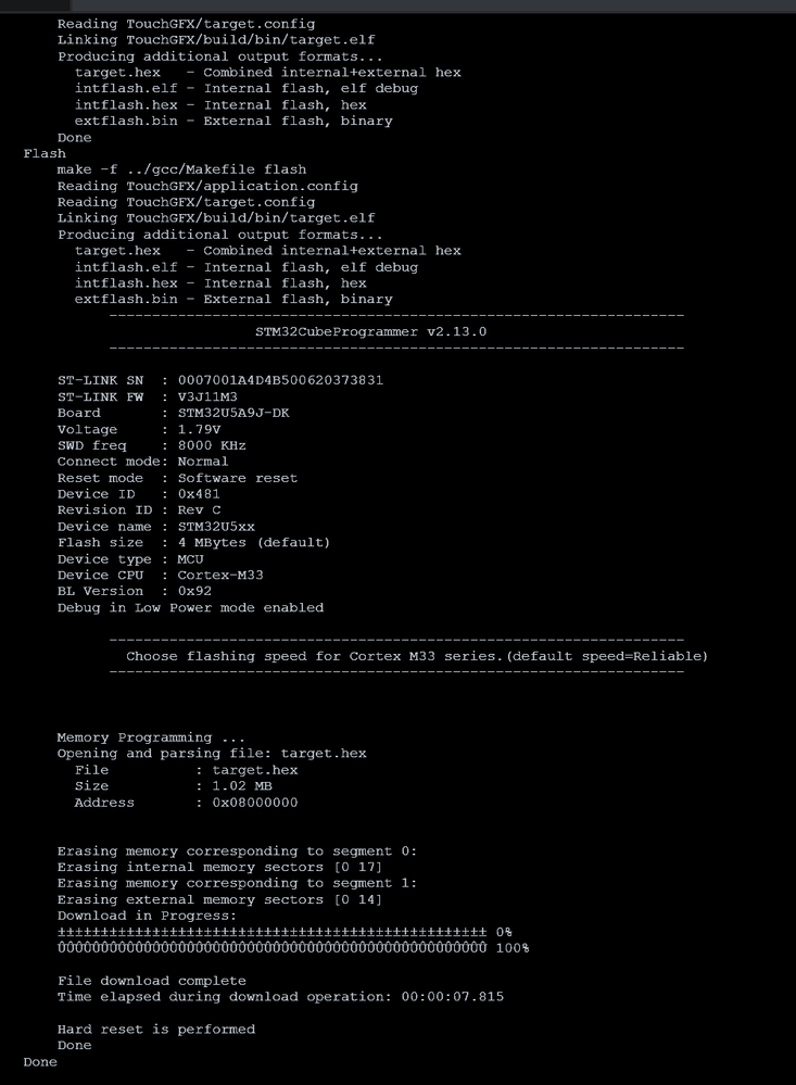

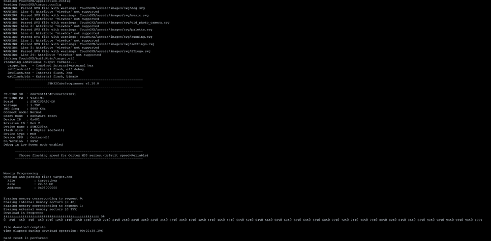

Same identical problem me too, using same board and same configuration.
With a little amount of space of images in external memory, like one or two little images in project, it work.0693W00000bhHI6QAM.pngBut with a large image and large amount of external memory used not work.
Any suggestion ?
Heeeeelp please :o
vitom
I have solved ! 
The problem is with STM32CubeProgrammer v2.13.0, the internal one used by TouchGFXDesigner and STMCubeIDE.
I have found the folder where STM32CubeProgrammer v2.13.00 is installed and I have copied over the old folder where STM32CubeProgrammer v2.10.00 was used.
Now TouchGFXDesigner and STMCubeIDE working fine with STM32U5A9j.

We identified the issue and we're working on it. Our apologies for this inconvenience. As a workaround, for now, you can use STM32CubeProgrammer v2.12.0 to flash your STM32U5A9J-DK board.
We'll make sure to patch this in the 2.14.0 version of STM32CubeProgrammer.
