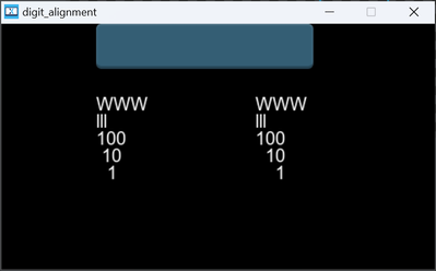

I want to align digits without prepending with 0. So %3d instead of %03d.
000:00
100:00
 10:00
 1:00
With non-monospaced fonts, such as verdana this doesn't work due to the space character not having the same width as digits. I don't care about the width of punctuation. All digits do have the same width in most non-monospaced fonts, but the space differs.
Unicode has different space types. Such as U+2007 "FIGURE SPACE" (https://jkorpela.fi/chars/spaces.html). This character should be a space character with the same width as a digit. Not all fonts support this character(https://www.fileformat.info/info/unicode/char/2007/fontsupport.htm). Arial is non-monospaced, but supports this character.
Below is a demonstration with ARIAL with regular space and "FIGURE SPACE"
WWW:WW
lll:ll
000:00
100:00
 10:00
  1:00
WWW:WW
lll:ll
000:00
100:00
 10:00
  1:00
As you can see (if the forum renders this correctly) the width of characters differs, but digits have the same width. And the "FIGURE SPACE" is the same width as the digits. So that's good.
But if I try this in TouchGFX it doesn't work as regular spaces are used. I wrote some code to add this, but ideally this should be implemented inside TouchGFX snprintf method:
textArea1.setLinespacing(-5); // alignment is easier to see this way
textArea1.invalidateContent();
Unicode::snprintf(textArea1Buffer, TEXTAREA1_SIZE, "WWW\nlll\n%3d\n%3d\n%3d\n", 100,10,1);
textArea1.resizeToCurrentText();
textArea2.setLinespacing(-5);// alignment is easier to see this way
textArea2.invalidateContent();
Unicode::snprintf(textArea2Buffer, TEXTAREA2_SIZE, "WWW\nlll\n%3d\n%3d\n%3d\n", 100,10,1);
bool typographySupportsFigureSpace = true;// TODO: how to detect this?
if (typographySupportsFigureSpace)
	auto len = Unicode::strlen(textArea2Buffer);
	for(auto i = 0; i < len; ++i)
		if (textArea2Buffer[i] == 0x0020)
			textArea2Buffer[i] = 0x2007; // "FIGURE SPACE"
textArea2.resizeToCurrentText();
Result (when using ARIAL and adding the needed characters to the typography):
So it works. But I would have to implement this for every single aligned text field. And I cannot simply replace all spaces since some of them should be normal spaces. In my opinion aligning digits is a huge aesthetic improvement over having them jump around and it doesn't add much CPU overhead. I was able to succesfully modify an existing font that lacked "FIGURE SPACE" and didn't have monospaced digits using fontforge. I made all digits equal width, centered them, removed kerning pairs and added the "FIGURE SPACE" character. This worked. So adding support for "FIGURE SPACE" in an snprintf variant is a huge benefit since you can make it work with all fonts if you are willing to edit them.

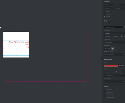

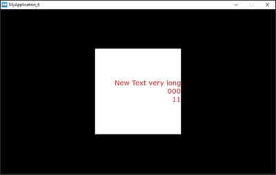

unsigned_char_array
Lead III
June 24, 2024
Aligning text to the right in a text area with wildcard doesn't work in a container. It always centers the text.
I print minutes and seconds.
It kind of looks like this (if the forum renders it correctly):
100:00
 10:00
  0:00
I've set the alignment to the right, but I don't see a difference with left or center alignment.
I tried upgrading to TouchGFX 4.24.0 but the problem persists.
How can this be?
"FIGURE SPACE"  still seems the best solution at the moment for non-monospaced fonts. I will implement my own printf function.
I have one more question: why is there a separate float print function in TouchGFX?
"Kudo posts if you have the same problem and kudo replies if the solution works.Click ""Accept as Solution"" if a reply solved your problem. If no solution was posted please answer with your own."
GaetanGodart
June 24, 2024
Hello @unsigned_char_array ,
I was able to put a textArea inside a custom container, align that textArea to the right:
Can you share a project where the alignment misbehave, this sound like a bug.
The separate float print function have for description : "Variant of snprintf for floats only. The format supports several \%f with flags/modifiers".
I assume it is optimized.
Regards,
Gaetan GodartSoftware engineer at ST (TouchGFX)
unsigned_char_array
Lead III
June 24, 2024
I created a new project from scratch in TouchGFX 4.24.0 and replicated the result. I used Arial and right align a field, but it clearly aligns left.
I think it's due to resizeToCurrentText. I think that doesn't take alignment into account. Resizing should move the left border of the text box, not the right border if it is right aligned.
I found the solution while typing this post: Using resizeToCurrentTextWithAlignment() instead solved the problem.

In order to add a font to TouchGFX it needs to be copied in the asset folder when TouchGFX Designer is closed (/TouchGFX/assets/fonts/). I noticed that I sometimes had to clear the font cache (/TouchGFX/generated/fonts/) if I updated the font in the asset folder. (An alternative is to change the font in typography and change it back again, but then a new font appears in the asset folder, which had to be deleted manually). If I didn't clear the cache the font would not render properly (It looked like a shifted font table, it rendered multiple partial characters in the place of one).
The simplest way to prevent digits moving horizontally is to set the text as right aligned in TouchGFX Designer and use resizeToCurrentTextWithAlignment() after updating the string:
	Unicode::snprintf(textArea1Buffer, TEXTAREA1_SIZE, "%3d:%02d.%d S", m_timeSecondsMul10/(10*60), (m_timeSecondsMul10/10)%60, m_timeSecondsMul10%10);
	textArea1.resizeToCurrentTextWithAlignment();

Instead of copying the figure space character from wikipedia or some unicode table website and pasting it in the "wildcard characters" field where you cannot really see it I paste 0x2007 in "wildcard ranges" e.g. "0-9,A-Z,a-z,0x2007". In other words you can paste the hex code of single characters in wildcard ranges. Ideal for white space characters.
I initially tried to rewrite vsnprintf. I thought I could delegate all formatting to existing print functions and only override the number formatting. This worked. But it was more than 500 lines of code. So I opted for something simpler:
//#include <ctype.h> // for isdigit()
// isdigit() from ctype.h crashes for non-ascii characters such as 0x2007, assertion failed, in visual studio
static inline bool isdigitUnicode(touchgfx::Unicode::UnicodeChar c)
 return c >= '0' && c <= '9';
void replaceSpacesBeforeDigitsWithFigureSpaces(touchgfx::Unicode::UnicodeChar* s)
	touchgfx::Unicode::UnicodeChar *start = nullptr;
	touchgfx::Unicode::UnicodeChar *s_ptr = s;
	if(s == nullptr)
		return;
	while(*s_ptr != '\0')
		if ( isdigitUnicode(*s_ptr) )
			if (start != nullptr) // if digit follows a series of 1 or more spaces
				while (start < s_ptr)
				 *start = FIGURE_SPACE; // replace
				 ++start;
				start = nullptr; // reset marker
		else if(*s_ptr == ' ')
			if (start == nullptr) // only mark first space
				start = s_ptr; // mark first space
		else // no space or digit so reset
		++s_ptr; // next character
In order to detect if figure space is supported:
bool fontCharacterSupported(const touchgfx::Font* fontPtr, touchgfx::Unicode::UnicodeChar c)
	if (fontPtr == nullptr)
		return false; // no font so no character is supported
	auto fallbackChar = fontPtr->getFallbackChar();
	if (c == fallbackChar)
		return true; // fallback character is always supported
	auto fallbackGlyth = fontPtr->getGlyph(fallbackChar);
	auto glyth = fontPtr->getGlyph(c);
	return (glyth != nullptr) && (glyth != fallbackGlyth);
bool fontCharacterSupported(const touchgfx::TextArea &textArea, touchgfx::Unicode::UnicodeChar c)
	return fontCharacterSupported(textArea.getTypedText().getFont(), c);
Definitions and prototypes:
#include <touchgfx/widgets/TextArea.hpp> // for touchgfx::TextArea
constexpr touchgfx::Unicode::UnicodeChar FIGURE_SPACE = 0x2007;
bool fontCharacterSupported(const touchgfx::Font* fontPtr, touchgfx::Unicode::UnicodeChar c);
bool fontCharacterSupported(const touchgfx::TextArea &textArea, touchgfx::Unicode::UnicodeChar c);
void replaceSpacesBeforeDigitsWithFigureSpaces(touchgfx::Unicode::UnicodeChar* s);
I placed all this code in FrontendApplication.hpp and FrontendApplication.cpp
example code (executed every x ticks):
static int counter = 0;
counter = counter >= 10 ? counter/10 : 123456;
Unicode::snprintf(textArea2Buffer, TEXTAREA2_SIZE, "a b %6d", counter);
bool typographySupportsFigureSpace = fontCharacterSupported(textArea2.getTypedText().getFont(), FIGURE_SPACE);
	replaceSpacesBeforeDigitsWithFigureSpaces(textArea2Buffer);
The first character and the last digit now stay perfectly in place regardless of the number of digits and the values of the digits. This is exactly what I wanted.
