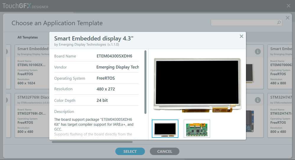

I'm using an STM32F746 based board from EDT (http://www.edtc.com/sb_readmore.php?id=23), which can be selected as an application template in the TouchGFX Designer and start from there with the IAR toolchain.0693W000000VAymQAG.png

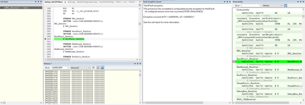

I'm having troubles being able to perform operations on the internal flash (erase/read) after the initialization of touchgfx is done:

I am able to perform those operations if I don't call touchgfx_init(), which makes me think that there are some instructions in there that may be using the flash or maybe locking the HAL or something like that.

However, I've spent a good amount of time trying to debug it and I have noticed a few things that might help solving it:
  • When debugging the program step by step, if I step into the erase instruction it does it successfully (if I don't, the debugger is hung there)
  • If I do the same when reaching the program instuction (step-by-step as done above) it is able to do some iterations before it hangs.
  • When hung, if I hit pause it brings up a HardFault Exception "The processor has escalated a configurable-priority exception to HardFault. An unaligned access error has occurred (CFSR. UNALIGNED)". View of the debugger screen below.
pxTCB = listGET_OWNER_OF_HEAD_ENTRY( pxDelayedTaskList ); /*lint !e9079 void * is used as this macro is used with timers and co-routines too.  Alignment is known to be fine as the type of the pointer stored and retrieved is the same. */
    0x8008498: 0x6ea1         LDR       R1, [R4, #0x68]
    0x800849a: 0x68c8         LDR       R0, [R1, #0xc]
    0x800849c: 0x68c5         LDR       R5, [R0, #0xc]
This is the instruction that's raising the exception as the fault exception viewer says.
If I can provide anything else of use, please let me know. Thank you so much for reading.
