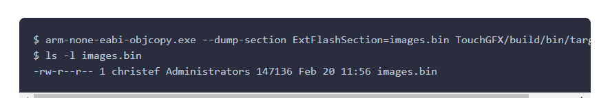

Does keil have a similar approach, or do we have to manually switch?0693W000000V81TQAS.png

What do you mean by "manually" switch?
/Martin
Hi​ Martin
I'm sorry.I have a problem with my statement. Does armcc have a similar approach? "Manually switch" means that we use some tools to change each picture from PNG to bin.
/korry
Use INCBIN in startup.s ?
http://www.keil.com/support/docs/3770.htm
For pulling content from an AXF/ELF, look at FromELF tools
Thank you very much for your help. I found what I wanted.
