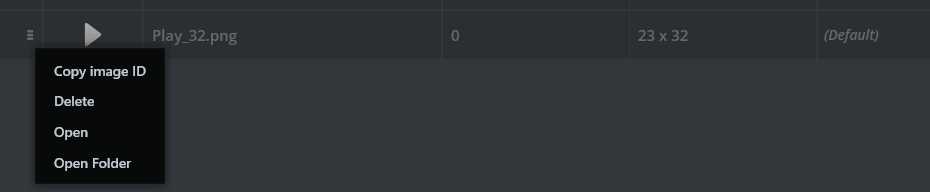

I have a button with a pause icon on it in TouchGFX, and I want to know how I can change the pause icon into a play icon after it is pressed. TouchGFX only gives me an option to change the icon while the icon is being pressed.
Thank you, so I was able to do the task by using the setBitmaps function. Here's the code I came up with:

also include "BitmapDatabase.hpp".
the bitmap id can be found in the images section of TouchGFX:

TouchGFX Designer can't do this for you, you must make code by yourself, fortunately, there is many demo can help us, for example demo "audio_player_screen", my board is STM32H747i-DSCO. the demo can download from github.
