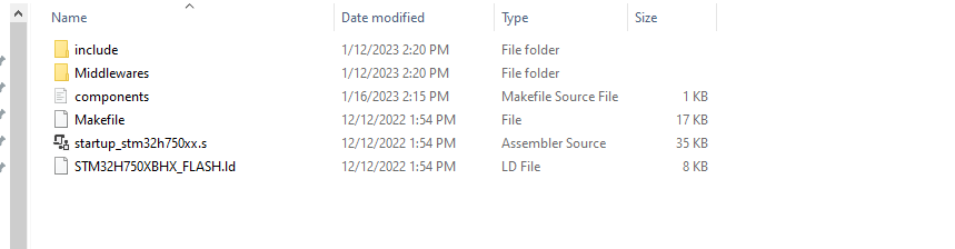

Do you mean makefile on gcc folder in the PC right ? not in the software right?

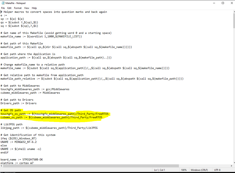

This makefile right?
0693W00000Y8I3PQAV.pngDo i need to delete these path only ?
i send you my makefile
Yes this Makefile :thumbs_up:
Delete those lines, but also the ones refering to touchgfx_os_path and cubemx_os_path, and all other things related to "os". I've tried cleaning this one (instead of deleting I just removed the path and files references), cant promise it will work but got rid of all i could think of.

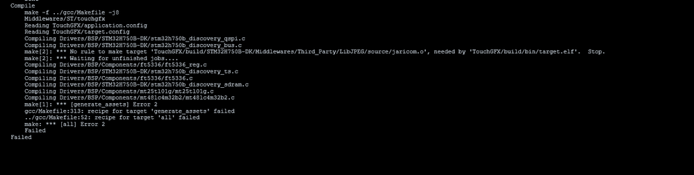

I run the target and got this error using the makefile you send
arh yes, do you need to use the video widget ? The error comes from what is necessary to make this widget work, linked to FreeRTOS in this project. If you dont need the video widget, then you can get rid of all those references as well (all the middlewares/third_parties)
